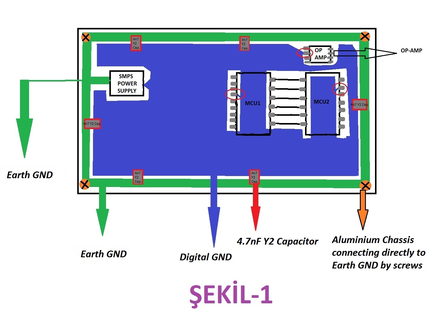

How Ground Plane to Chassis GND connection?
kaSva
Nov 26, 2013
3
Nov 26, 2013
3
Hi,how should i connect digital gnd to device chassis GND.I tried a way.But i dont know "is it correct".What is your idea about it. You can see below.Thank you
