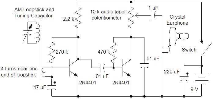

typical regens use changes in the operating point of the transistor to demodulate the RF
http://www.techlib.com/electronics/crystal.html
So is this what is happening that is resulting in any transistor that I connect to my guitar (guitar amp or audio mixer) will demodulate RF into audio?
but then how would transistors used in RF amps work if all the transistor did was demodulate the RF into audio?
Here is a schematic from that website that shows a crystal receiver with a transistor instead of a diode! (I think it is better than a diode because it amplifies the RF simultaneously as it demodulates it resulting in the RF tuned to having greater voltage to drive the tank circuit so it has greater frequency selectability):

http://www.techlib.com/electronics/crystal.htmlbut then how would transistors used in RF amps work if all the transistor did was demodulate the RF into audio?
They work because the circuit is designed to amplify that frequency.
Circuits that are not designed to handle a particular type of signal may behave strangely when that signal appears on an input. If the signal enters via some other method power supply for example) then unusual things might happen even if the circuit is designed for that signal, because the signal is not arriving at the input.
The signal could be too high or low in frequency, it may be too high an amplitude, it may have an incorrect DC offset. In some cases the amplitude might even be too low.
The strange thing it does may include demodulating the signal -- or the effect that you notice is a demodulation of the signal.
These things are often not entirely predictable and often not interesting to explain except insomuch as it takes to eliminate the cause.
It's a bit like having a flat tyre and noticing that the car steers left. One is typically not interested in determining exactly how much reduction in pressure it takes to turn the car left a certain amount. One would not really be interested in reducing the pressure in your tyres to turn a corner. You just want to get the tyre repaired.

Oh okay, so the regen detector only works to demodulate because it has a difference of gain of RF signals to compare to so the high gain RF signal when combined with the low gain RF signal, in accordance with the principle of linear supposition, the resulting output of the mixer has the wave peaks of modulation index of increased amplitude enough that the audio is loud enough to drive an audio pre amp transistor (or tube) and the RF remaining is ignored by the audio gain section since the audio gain section can not handle RF (and also a filter can be added to remove any remaining RF to prevent RF from being demodulated again by the audio gain section from either accidental tickling of signals by induction interference or from the unpredictable behavior of an audio transistor at RF).
So a transistor or tube has unpredicatable behavior when it receives a signal at a higher frequency than it can respond to (such as if the transistor or tube is designed for audio), and one of these unpredicatable behaviors is demodulation.
So in summary, a transistor or tube designed for an audio application will most likely demodulate RF while a transistor or tube designed to handle RF will not demodulate RF.
Well so I think an audio transistor or audio tube would be better than a diode in a crystal set since a diode has too much loss since its a passive component, correct? At least that's what that website that I showed you seems to think.

It's more the circuit than the actual device. For example the transistors in an audio amplifier may be capable of working up to (say) 100MHz, but the circuit they're in isn't designed for those frequencies.
A tube diode will have vastly more losses than a semiconductor diode.
An amplifier only amplifies because there's power going in tot he amplifier from a power supply. The crystal radio doesn't have external power.
Look at biased diodes if you're interested in a way of minimising loss in the diode (with additional external power though)
I might be sorry, but here is another way using a device that has a very low turn on voltage.
