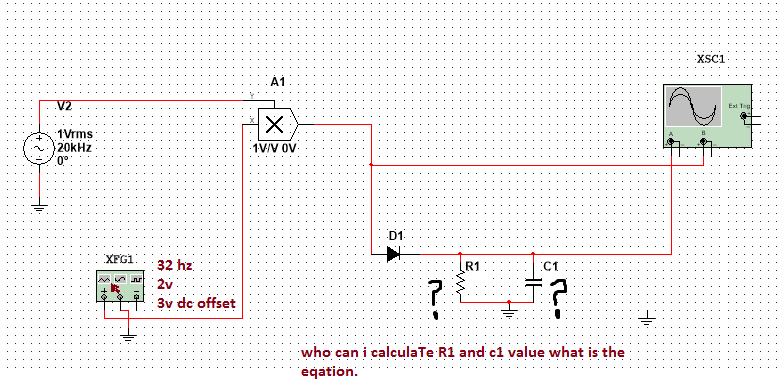

Hello , one question if posible .
How can I calculate the value of R and C for an Am Demodulation envelope detection circuit.
Knowing that the carrier wave is 20KHz, 1Vpp, and the message signal is a 32Hz, 2Vpp, with a 5V DC offset:
and thank you.

Hi Bilal12,
Firstly, I would cheat! As the equations turn my brain to mush!
I would stick a 1K and a 1nf to start. Or a varistor. And adjust the cap. Maybe 5nf 10nf.
But have a read of the books as the equations are all there.
Martin
Martaine2005
May 12, 2015
5,318
May 12, 2015
5,318
It would appear your question has already been answered on another forum!
The equations were there too.
39nf and 5.1K
Martin

thank you for your replay . but who did you get c=39nf and r=5.1K

Your circuit looks very strange, shouldn't the ground terminal of the scope be connected to ground.
I would not know how to calculate the values but R needs to discharge C fast enough to follow the wave form. The DC offset will affect the discharge rate and may allow 100% modulation to be detected without distortion.

I think if you started off with an RC of 5 times the 1/fm (modulation frequency) and see how you go. There is a lot of contention over what formula to use. So try this first and see how you get on.
