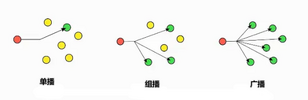

Transmission Modes
The walkie-talkie supports three transmission modes: unicast, multicast, and broadcast. To configure these modes:
- Unicast: Set the DESTID to a non-zero value to specify the communication target.
- Multicast/Group Communication: Set the PANID to the same value on all devices within the group.
- Broadcast: Used for communication with all devices in the network.
To isolate communication physically, configure the transmission frequency point for the devices.
