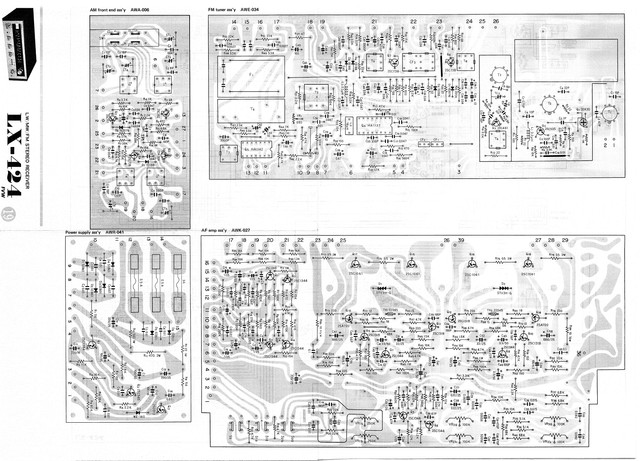

I'm sure we'll want to see any circuit diagrams you have for the amp. Also please post a good, clear photograph of the inner workings of the amp, showing the part you want to replace.

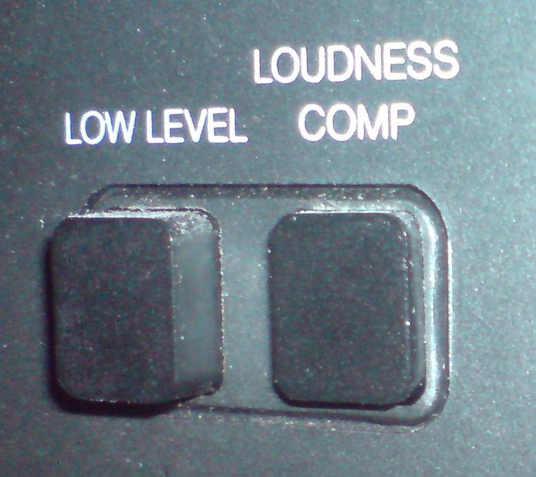

umm, there's no such thing as a "loudness tap". Please explain what you mean!

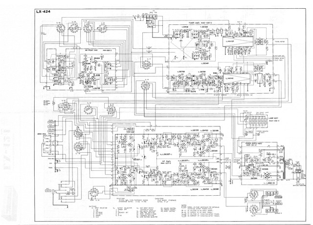

I'm not familiar with the Pioneer receiver, but my NAD 3020 amp's volume control (VR1) has a tapping which leads to the Loudness control switch (SW5). If your receiver's volume control similarly has a tapping then I doubt the linked digital volume/tone control module would be compatible as a direct replacement for the just the analogue pot.
However, if the digital module has in-built volume and tone controls then it should be possible to use it to bypass the existing volume and tone controls altogether. Unless that module specifies a loudness control function you would have to forego that feature.
Edit:
1) Looking at the pic of that digital module, it has one manual control. It is not clear how both tone and volume can be individually controlled.
2) Are you aware it would need a 12-15V supply?
3) Would that module fit in the receiver?

According to your posted schematic (if I'm reading the fuzzy text correctly), each half of your volume control (VR1a,b) is 250k and has a tapping for the loudness control switch (S7a,b). Nothing in the write-up of your digital module suggests it has (or emulates) such tappings.
