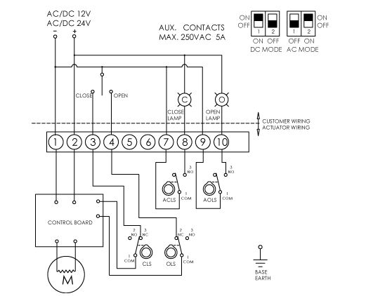

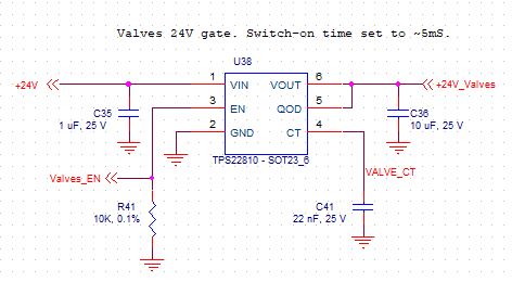

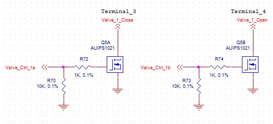

the AG-020-B electric actuator is controlled from a microcontroller. Terminal 1 is connected to the DC PSU GND, Terminal 2 is connected to the +24VDC via a high side Power MOSFET(TPS22810) as shown below. This is for power saving.
Low side MOSFET (AUIPS1021) Q5A and Q5B are used to control the opening/closing of the valve via terminal 3 and 4. The microcontroller I/O lines Valve_Ctrl_1a and Valve_Ctrl_1b provide a 3.3V signal.
- Comments are welcome regarding the power and switching circuitry.

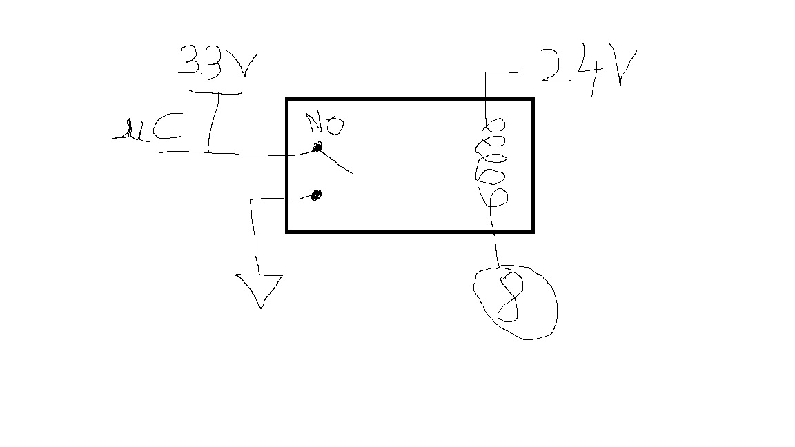

- Any suggestion on how to monitor the feedback lines on terminal 8 and 10 from a microcontroller. A lamp is not suitable as the system will be enclosed in a box. I've come up with a relay as a possible solution but I would rather use discrete devices.

Got around to doing your sketch. See attachment.
Couldn't be simpler.
Circuit is same for both.
There is no actual lamp in the real thing, it's just an example from the datasheet. And you have only access to one side of terminal 8 (customer wiring)
