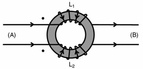

To reduce common mode currents, simply take the cable which should be shielded, and pass it through the ferrite ring several times.

So to make a common mode choke with a ferrite ring, when I look at this design, would I have to split apart the two speaker wires and left goes on top and right goes on bottom, or is this design only for mono and the top is hot and the bottom is return?
Or will it still work if the unmodified stereo speaker wires cable is simply wound around the ring?
