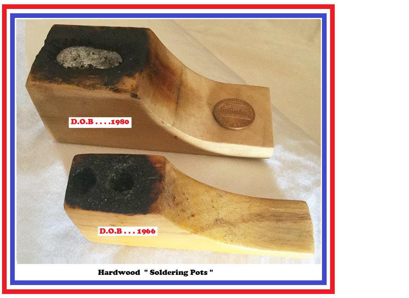

Sires . . . . . . .
Soldering pot . . . SOLDERING POT ? . . . . . what is a a soldering pot ?
Oh, yes, now I remember, that's the DRAKE unit that I gradually stopped using, about 1956.
Ye olde tyme DRAKE " solder crock pot " . . .circa 1948
Wire gauge and components became smaller, less wiring required tinning and those new fangled printed circuit boards started appearing.
In the early days of circuit boards I made sure that all my components leads and wires were WELL solder / tin wetted.
Rather than pulling out that BIG old power hungry unit, in about 1966 I made a variant, that since, has well served my needs.
It is the bottom unit of the two below, it was constructed from a slab of Amerikanski Oak wood.
It's dimensioned at 2.2 cm thickness . . . 9 cm long and 4cm high.
The very top was divided into 1/3's and an initial prick drilling with a 2 mm drill bit made 2 holes. That would then hold the drill tip such that it could then be tilted to slope drill the 2 holes so that they intersected and met about 2.5 cm down.
That then establishes a good drill path, such that a larger 7.5 mm drill bit enlarges those initial pilot holes.
8 time separated coats of marine spar varnish completed the unit . . . .that was the best coating at that timeframe.
Still . . . . . .lookin' good . . . . . . after 60 years of service.
But it has received a break, since about the 80's . It only get's pulled out whenever I misplace the new one for a time.
"Road kill" from a neighbors curbside castoff yielded a solid hard rock maple table top.
The new units construction expanded its length to 10 cm and 4 cm wide and a clamped gluing of two 2.2 pieces resulted in the almost same 4.4 cm height.
The new sloped drill holes are now 1.25 cm. This new unit received about 10 coats of Varathane poly.
My only change, if building another unit , would be to cap off the units very top with an anodized aluminum plate .
Those plate edges are draw / mill filed to a chamfer . . . making a perfect fit to the wooden top.
4 brass brads slightly inset from the 4 corners, inserted into pre drilled, slightly undersize holes, then with the brass brads driven home.
HOWITWORKS
My big unit serves both for a solder tinning pot and a soldering iron tip tinner.
The special sloped shape on one end of these units serve for the fingers and thumb to be able to hold the unit down, well clear of a hot area.
If your iron tip needs tinning, you start it's warm up and start scraping it against the solder blob in the unit.
As soldering iron temperature ncreases, some metal transfer will be initiated as well as some oxide will be scraped off from the yet quasi solid surfaces.
When you start seeing the very initial onset of a molten state of the solder blob, place 5 or so drops of rosin flux *** atop the solder blob.
Continue scraping and rotating the tip and you should end up with a tinned tip, sitting down within a molten solder blob.
I use a 50-60 watt iron . . . . .and after having bought a lower wattage iron back in the dark ages, NEVER will I have less than a 50-60 watt unit.
You can ALWAYS decrease voltage with a series silicon diode in the worse case; or use a lamp dimmer to trim into exactly the temperature that you want.
Small soldering tips can be custom made for cramped quarters or small work .
PLUS the axiom when using higher temp is get in and get the job done in a hurry . . . .because it has no heat hesitation and will do it in a hurry . . . . and then move the iron away.
If you want to progress to the solder pot function, dip the tip down ever deeper and also start working on the other adjunct solder blobs cavity.
It shouldn't be too long until both blobs are molten.
That's when your iron tip is left at the rear large end and the frontal hole is where you do dip tinning.
Grab that scraped / cleaned item which is to be solder tinned and dip it in rosin flux.
Then you dip it down into the frontal molten solder blob, to then take on tinning and then rapidly lift up and out . in order .to avoid an end solder spike.
If I have MANY tinnings to be done, I have a lamp with a 1/2 cm back riser, i just position the two and use an Acco clip to hold the soldering iron cord to the riser and the adjusted dangle of the soldering iron, then lets its tip rest down within the rear solder blob.
Cheeep materiel:

YE OLDE TYME WOODEN SOLDER POTS :
