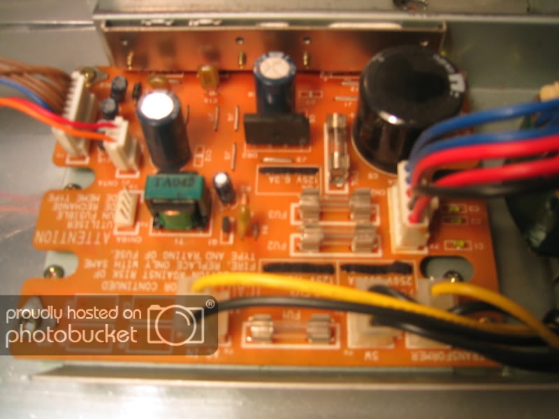

That sounds (pun) like a thermal intermittent in the power supply section which could be caused by an electrolytic capacitor or something else. You should rule out flaky connections and solder joints by poking around with an insulated probe (stick) with the power on before you go after the capacitors. The synthesizer probably develops several DC voltages which should each be checked. Do you have a multimeter or oscilloscope? Do you have a schematic? Can you post a clear, well-lit (not flashed) picture of the power supply section?

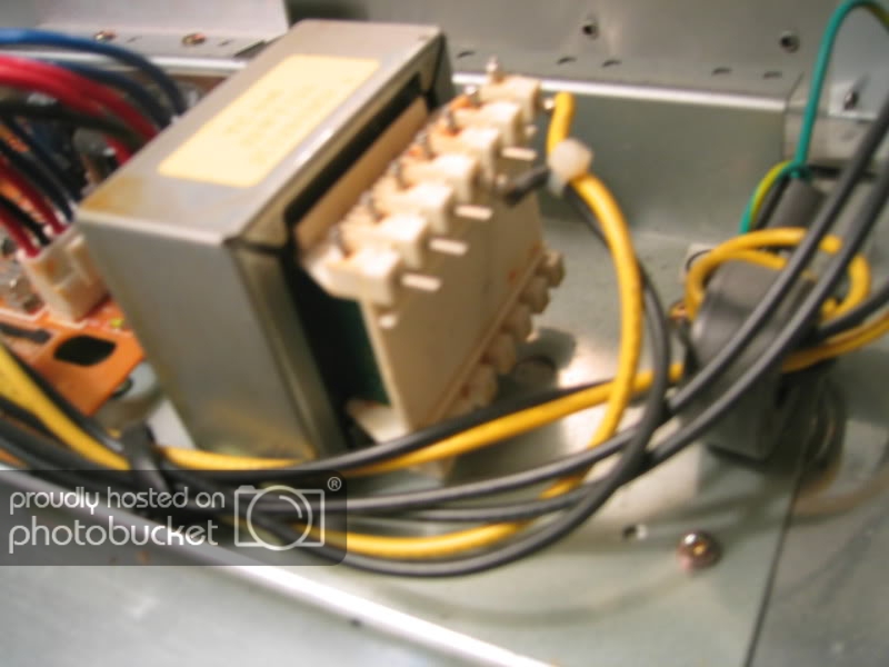

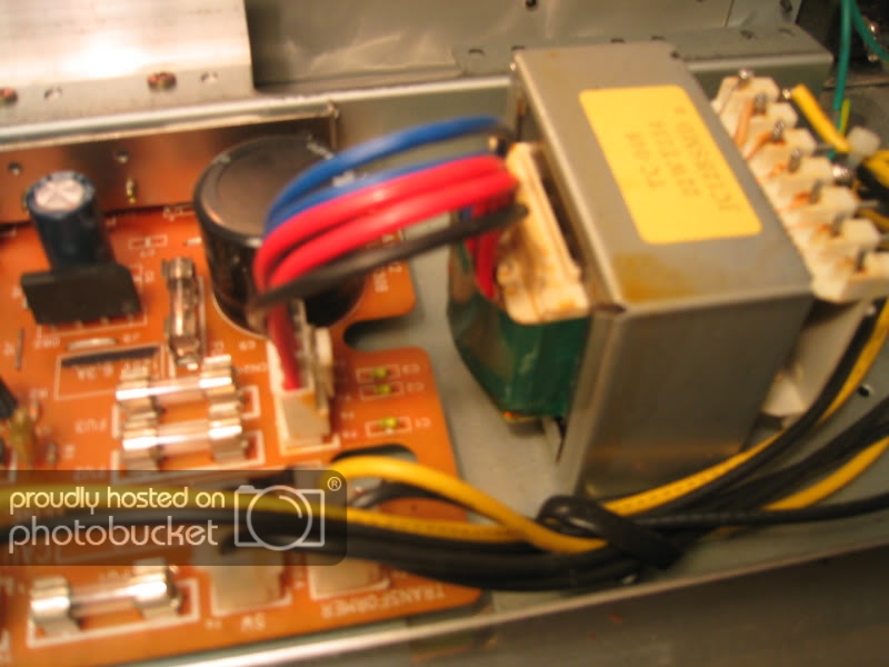

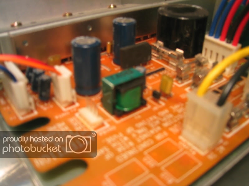

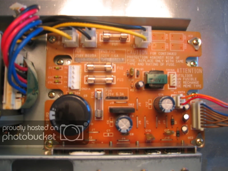

Yes I have a simple multimeter and a pdf of the service manual with schematics, not that I can fully understand what I'm looking but it has helped some. I'll try checking for faulty connections.
Here are some pics. If they're too blurry I can take some more. I feel pretty confident that I checked those fuses correctly and they seem fine.

So there doesn't seem to be an IC3 79M12 on the power board. I can see it on the schematic but not on the board. you can see the picture above that i posted to confirm. IC52 does not seem warm. The only ICs that get warm are, on the main board, IC36, IC37, and IC38. IC38 get really hot actually.

IC1–IC3 are on the extreme edge of the power PCB clamped to the chassis for heat sinking.
