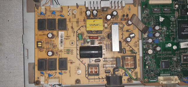

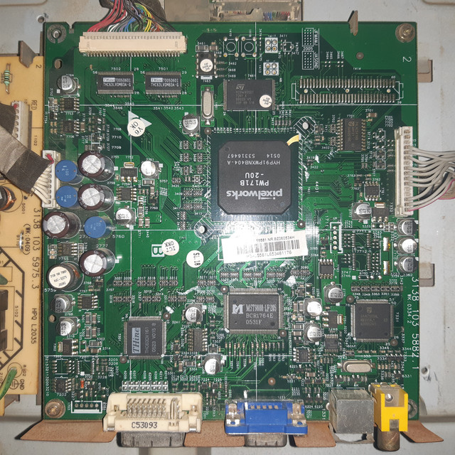

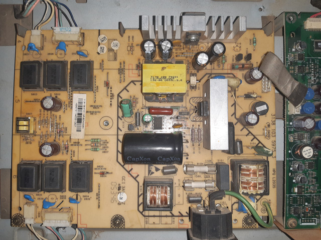

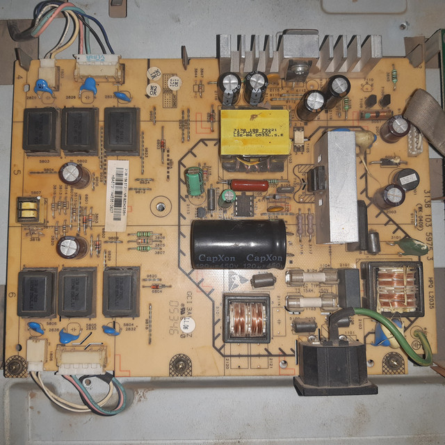

of-course i tried it on different computers with different cables and still the same issue which made me believe it's a hardware issue in the monitor it self
i uploaded some pictures , hope any one can help me fix it
what should i check first

In the mean time, does it have any indication of power?, back light?LED?, noise?.
Have you checked the fuses on the board and in the plug (if it has one)?.

It seems to have power or at least standby power.
I would check all inter-connect cables to both boards. Unplug and reseat. Check for cracked or dry solder joints. Check those cables for continuity too.
Your photos are too fuzzy to enlarge.
Can you see a connector that may have voltages written on the silk screen?. If so, check those voltages.

On the PCB, there are reference designators. R32, C14, F2 etc. Not necessarily the numbers I wrote.
Any lettering, numbering or symbols are silk screeen printed onto the PCB.
You might have a connector with eg: 5V+, 12V+, 28V+, 0V.
They are voltages on those connections and therefore those rails.
Martin

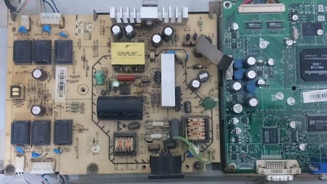

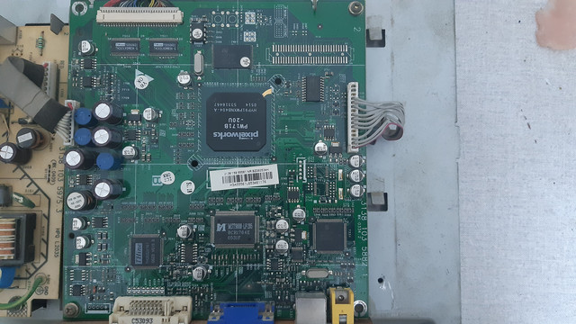

checked and all seems ok
there's none

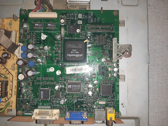

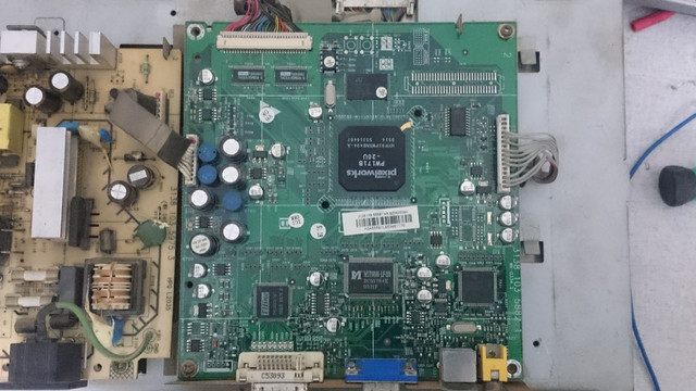

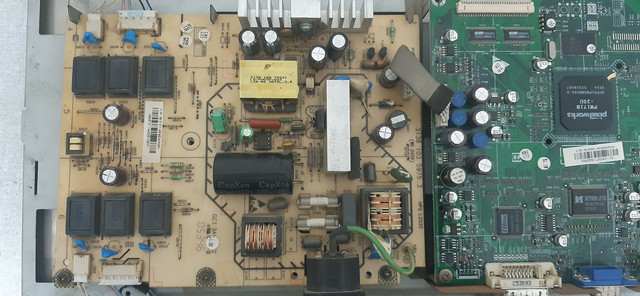

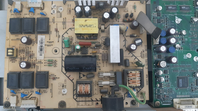

got new set of photos with decent resolution ,you can click on the image to open it in it's normal size

I have seen similar problems caused by power supply issues in monitors. However these faults often develop over time. They are also faults that tend to occur in older equipment, or equipment that has been continuously powered on for years.
I would be checking the ESR of the capacitors in the power supply. I've taken a look at your photos and none of the capacitors look stereotypically faulty.
