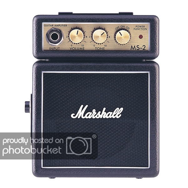

I doubt it would produce enough power to simply hook it up to a larger speaker, think you would need some sort of amp or small preamp to get the volume you require,
Possibly a pocket guitar amplifier, think they produce around 10 to 15 watts that may work and you could also use the speaker from it.
Yes, she will need an amplifier of some kind, which will need batteries.
correct Kris,
was thinking of something like this
The MS-2 is the ultimate in portable battery/mains operated micro amps, packing full Marshall tone into a tiny case measuring just 14cm x 11cm x 6cm. This mighty micro Marshall has switchable Clean and Overdrive modes. A single Tone control provides full focus of bass to treble.
The MS-2 has headphone output for those who want to rock in private. This output can also be used to drive an external power amp when your rambling is done.
Features/Specifications:
  • Output: 1 Watt
  • Volume: Yes
  • Tone: Yes
  • Gain: No
  • Headphone Jack: Yes
  • Power: 9v Battery
these can be picked up at online auction sites verry cheap ;-)
altho this one is only capable of 1 watt

In post #3 I suggested a BTL audio amplifier module capable of at least 10W. These are also available pretty cheaply on eBay.
