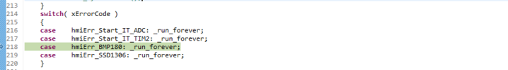

Hello,
I'm new on this forum, I could not think where to ask support, so I just googled "electronics forums" ... I hope I got in the right spot.
I'm not expert electronics engineer although I'm a CNC/Robots integration engineer. In our job we do not do electronics but rather we connect and program industrial devices.
I have made schematics and code for a vacuum pump controller that is controlling the pressure in a vacuum chamber using a vacuum pump and measure the pressure with an absolute pressure sensor. We use this system in our hobby to vacuum bag / laminate different composites for RC airplanes and drones that we build and fly ourselves.
The controller is made using a STM32F103C8 MCU, GY68 module ( BMP180 pressure sensor ) and an 1.3" OLED display. The pump is a 3 phase 0.18kW supplied from 2 phase 220V (VEVOR 1/4 HP pump).
All tests work fine, the electronics and code, as long I do not connect the motor ( to controller terminals ).
If I connect the motor the controller goes in hard fault and halts at a certain point when the motor is swithced on. So it's kind of randomly but when the relay switches the motor on.
Innitially I used only the switching power supply 220Vca/5Vcc and supply also the controller but later I added a AMS1117 module in the circuit but the issue is still there.
I attached pictures with a schematic (it also shows where wires are connected ) and with the 3D printed box with the electronics.
I suppose It's something about inductive loads that is creating this behavior.
Can anyone help with some suggestions - what can we try do in order to avoid this behavior?

Does CPU hang ? Where does it halt in code, can you tell ?

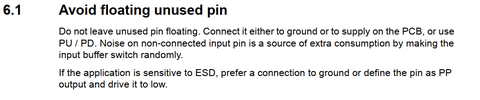

All pins not terminated in low Z suspect. Unused pins set as outputs.
Yes the CPU halts, it goes into a hard fault loop (function). I can test later today see in which function goes or if goes always in the same one.
Do you mean I should not set unused pins as outputs? I left the unused pins as they are by default in the CubeMX.
General recomendations :

Programming the correct I/O configuration is up to you. Set unused I/O-pins to OUTPUT (preferred for sensitive environments, see post 5) or activate the built-in pull-up resistors when left as INPUT pins.

So, I got a PC osciloscope Hantek6022BE. I connected the controller to CubeIDE so I capture what hard fault occures
I changed the 5V powersupply with a better one, I remved 3V3 stab and supplied the MCU on 5V point, I changed power supply wiring with thicker and shorter wires. Made one GND point from where I connect to MCU, and the other devices.
I connected the osciloscope on the 5V power supply at the coil + terminal and monitor the voltage... hope the Hantek is fast enough to trigger.
And now I seat since 45 min and no faults ... funny:D

Some feedback after all these changes...
I changed the code so that I've checked i2c comm's with OLED and BMP180 every ~ 1 sec's using the function HAL_I2C_IsDeviceReady( ... ) .
It still does not works fine, but now the MCU does not goes in hard fault - I think that change of the power supply and better wiring sorted that part out. Will still continue monitor anyway ...
But now I'm left with a new identified issue - I suspect this was in all the way. The pressure at random moment in time makes a reading of 1750 mBars while normal reading is max 1010 mBar (at my altitude) and after that, the BMP180 does not responds anymore ... see picture. I got this same behavior 4 times today and no other.
