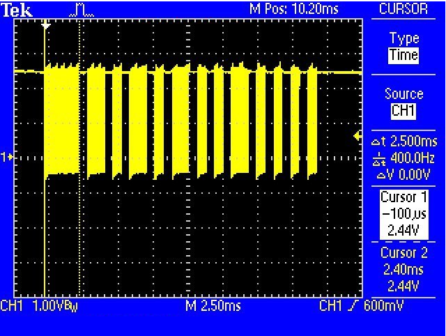

Visual:
This is a scoping of the stream of narrow and wide 38Khz pulses that modulate . . . .rapidly turn on and off . . . . your infrared LED trio.
To accomplish confirmation of there being a modulation presence, lets rely upon the fast rise times of those aforementioned generated 38 Khz pulses that will additionally create harmonics that extend W A A A A A Y on up into the low frequency RF/Radio spectrum.
Specifically . . .up around 550Khz on upwards to 1Mhz, is being our spectrum of interest.
That will coincide with the lower band of an AM radio receiver which I hope that you have and can find it as being a pocket portable or a bit larger portable.
In either case, they will be utilizing an internal ferrite loop antenna that collects and concentrates received RF energy within its small physical area.
To Evaluate:
Turn on the radio and place down near 550 or where NO AM radio station is being picked up, then max up the volume and bring one of the working remotes up near / kissing the radio and press a remote button repetitively.
You should hear a raspy tonal burst, THEN you move the remote ALL around the radio and try
all positions to get the strongest signal being received.
Congratulations, you have now found the internal loop antennas physical positioning and the "hot" spot on the remote hand unit. Make deep observation and take mental note.
Relevant factoid:
If you were to hear the "buzzzzz" of a housefly . . . .a mosquito . . . .a bumblebee you could differentiate them with your hearing acuity . . . . the same will be true in the case of the sequencing of these wide and narrow tone bursts, along with their arrangements.
An unknown variable . . . being left for you to evaluate.
Most remotes put out repetitive, yet identical tonal bursts when a remote button is constantly held down, confirm that this is true in your case.
(A rare case is for a single tonal blip being produced until the . . .or another . . . key is pressed again.)
Figuring that the first situation is being your case . . .get your TWO working remotes and hold them side by side, sharing that most sensitive / receptive position of the radio.
Press the UP button for one pulse blip and the like button on the other unit . . .they sound the same don't they ?
Then to FULLY test your aural acuity and tonal differentiation, change to pressing one remotes UP and the other ones DOWN.
Your brain should then tell you . . .Hey! . . . .I can HEAR the difference, when I am hearing one immediately after the other..
And then . . . .AND THEN . . . . you try that test sequence, using one good remote unit and that questionable unit, keying identical buttons alternatively on each remote..
Feedback time . . . . to see which multi branched trail to follow from here.

I don't see where all that audio analysis would be getting me as far as a solution is concerned.
Hmmmmm. . . . .I could have started out with:
FIRST . . . .
You need to get yerselfs a XXX hundreds (or) some are thousands of dollars, triggered oscilloscope or PREFERABLY, a STORAGE version of same and THEN you tie it into an infrared converter/detector unit to observe the serial data train info being emitted by the hand units IR LED's.
Then that will confirm IF a serial pulse train IS actually being created, and then by the comparison of the alternate . . .either wide or narrow pulse combinations . . . . . that they are being correct for the pressed pushbutton function.
OR . . . .
as Sir Hellas Tech.so aptly confirmed, hearing one known good units signal, immediately followed by a comparison from the suspect unit will confirm an identicallness of those same distinctive raspy tones.
