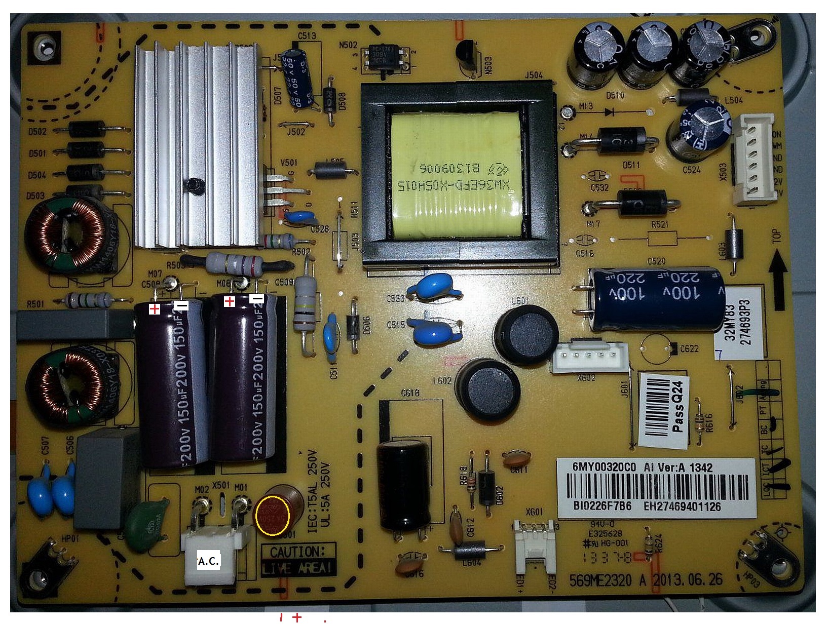

Here's an actual photo of the power board, if that helps.

Sir "Kilgore" . . . . . .
That set uses a special lag time electro chemical fuse.
Its module location is left corner, just right to the side of the white Molex AC line connector
It says CAUTION . . . . LIVE AREA, but in your area, that probably is not the norm, or they wouldn’t be there.
It’s reddish brown color . . .NOW YELLOW circled, a round cylinder and designated as ? F? 001 . . . of all that I can make out.
BUT the smart, fuller testing is to completely reinstall the board and connect up and do a voltage test..
Note the two black 150 ufd / 200V cylindrical electrolytic capacitors just in the area above.
Polarity is being further marked up for you.
After power turn on
Use DC metering in the ~200 VDC range to measure across the + and – leads of one filter then the other expecting ~ 160-170 VDC from each . . . if so . . . yo’ fuze iz gud ! . . . plus a whole STRING of intermediate parts.
Go to 500 VDC range and do a quick touch test to see what the voltage read is from the extreme right - term of the right cap to the extreme left + terminal of the left cap is.
As they just might be voltage doubling . . Put that voltage reading in your pocket and carry it back with you.
We now leave you, to go demonstrate your first degree of techno prowess.
I was just about to ask for as good of a photo as my post # 6 is providing, but being shot of the FOIL side of the board.
I initially got with you as far as the main filter capacitors and their having the required 165 VDC out from them.
Brief Operational Synopsis:
That voltage then feeds up to the LARGE cored YELLOW transformer with the power device associated with it, being the power FET to its left, peeking out of the right edge of its heat sink, you can see it as V501 device marking and its Drain-Source-Gate leads.
There is one 14 or 16 pin surface mount IC, other side of the board, which feeds gate drive to it.
It is working, as your transformer is operating and feeding power output to D511 and its companion just below it to create your 12VDC, which gets filtering by the cluster of elect caps above them.
White X503 connector below, has its Board ON—Pulse Width Modulation ---Gnd---Gnd--- 12VDC---12VDC pins..
Now we drop down to the boards right bottom quadrant, where the LED backlight clusters supply is.
There is where you found your driver IC and its associative power FET, on the foil s ide of the board.
You probably have either an overload or loss of some series LEDs in a strip causing your power cycling from this section.
Since I am working totally nekkid . . .. without a schematic, I need the foil side photo to “ read it “ .

Let’s just initially see all of the commonly grounded connections.
Extreme top right corner is the ground lug eyelet that gets chassis grounded by its mounting screw thru it.
Measure from there to both Gnds on X503 connector. Being Connected ? Expecting so.
Then keep one lead at the ground eyelet and confirm a direct connection to the neg terminal of the nearby C520 elect . Being Connected ? Expecting so.
Check for a direct connection to the – term of the lower left C618 elect. Being Connected ? Expecting so.
Check for a direct connection to the lower right white X601 connectors #3 far right LED connector pin. Expecting so.
This would be all expected common shared grounds.
Now back to the two large diodes to the right of the transformer.
The question is if they are used as a shared pair in getting your 12VDC over to the right X503 connector.
To confirm that, ohm between the silver banded ends of those 2 diodes. If they are connected both are creating your 12VDC.
HOWEVER . . . I suspicion that the bottom diode provides another supply, with it receiving its power from a higher voltage output winding of the transformer.
That voltage then gets initially filtered by C520 . . . and we can expect that voltage to be less than 100v.
The voltage then passes thru heavy ferrite based inductors L601 and L602 which may only provide passive RFI isolation filtering OR they might be active element(s) in an inductive kick back / ringing power supply, utilizing your back board find of the MP4012 switch mode driver IC which drives a SM2A04NSU power MOSFET(s).
Prepare to measure some voltages now, as you did on your last power ups.
Your readings have confirmed a constant 5VDC standby supply and a steady 12VDC supply as derived from your units central transformer. All is well there.
Measure across C520 to see what that peak DC voltage is, and if it is going up and down at the rate experienced on your MOSFET’s gate drive.
Move down and measure across C618 elect and see what is happening there, then probably the flow path is thru ferrite inductor lead L604 over to the X601 pin 1 LED +.
Our main interest being . . . in voltage levels and fluctuations.

Thanks for the reply, 73’s de Edd!
Let's start with the easy stuff. Here's new pictures of the board, front and back, with a clip in one corner for orientation reference. I'm off to record measurements. Be back in a short bit.
