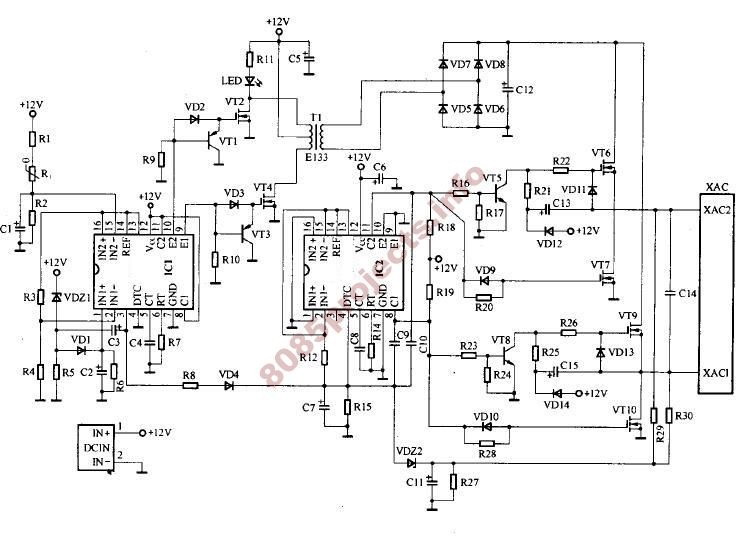

HI.... Is it posible to modify a dc inverter circuits which are inbuilt in crt television sets,
The inverter output is soldered directly to the crt power filter capacitor,
what if i remove the brigde, will it output stable 220VAC?!

you would have to tell us a lot more about the particular PSU
a circuit diagram is going to be essential before any good suggestions could be given

Davenn i tried googleling for the schematic but i found no matching circuit according to the one i have
The inverter board uses two ic's ne555 and sg3524n, smp transformer and two fets....
I tested its output with a d m meter and found 300 vdc, and at the transformer's output b4 the brigde, the meter shows high voltage....
Such inverter circuits are found in CRT TV's which operate with both AC AND DC voltage
I'm working on its schematic, i will provide it wen its done

If you remove inverter output bridge diodes , inverter outputs
310 vac 50 khz squarewave
It never outputs 220vac 50 hz

If it is a ferrite cored transformer, it will never be able to run at 50Hz.
To get 50Hz you will need an iron cored tranformer and the SG362 modifying to generate the correct drive. frequency.
This circuit produces square waves. The output can be filtered to give an approximate sine wave or a class D drive to generate a sine wave

If you want to take 220ac from your inverter in crt,you have to add this circuit. It converts 310vdc to 220ac
Apply this
You have 300vdc so you dont need ic1 and components around ic1

I also remove R8 and D4 its like a feedback or comunication between the two ics!

your right now the inverter outputs
__ 240vac without any load
__ 130 vac when i connect a 100 wat bulb , and the 240 drops to 40 vac when i connect a crt tv,
I tried another transformer and its output is 280 vac and drops to 180 when i connect a 100 watt bulb
but am still wondering why it just increases the voltage to 300 vac when i connect a crt tv
How to add the missing part of regulation,
