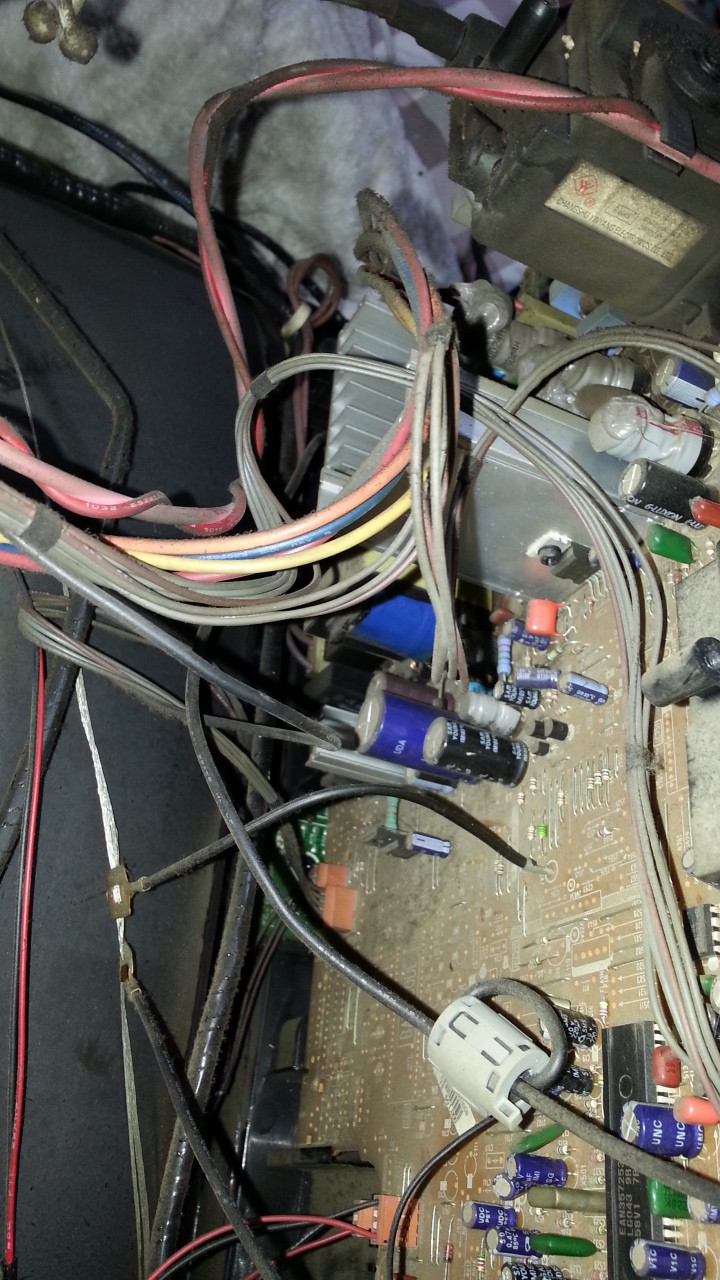

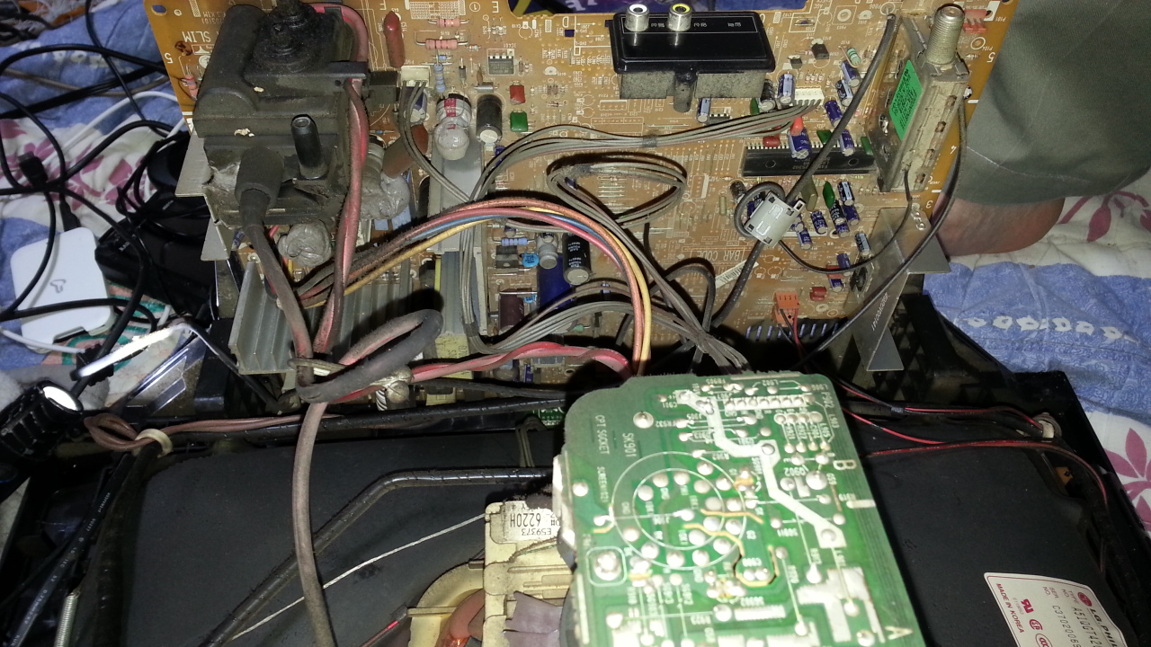

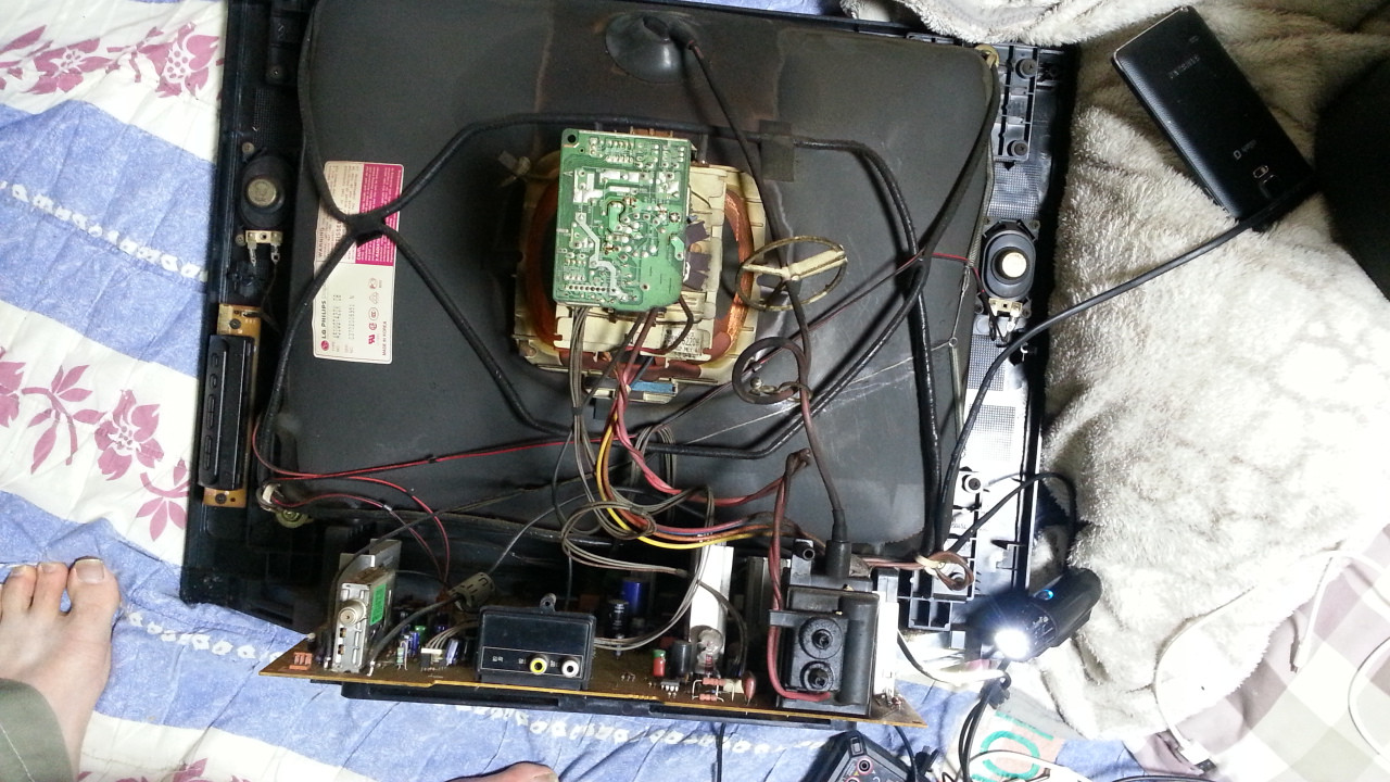

Thank you very much for reply!
I took pictures of PCB of this slimCRT TV and upload it to imgbb site.
I found that The biggest capacitor(main filter capacitor) is 400wv 220uf samwha capacitor and Its voltage is 280v.
I assume that its voltage must be measured less than 10-20v, If bleeder resistor(there is 8w large ceramic resistor which is adjacent to main filer capacitor) correctly works.
But two days ago, Its voltage was 315v and Now It is 280v.
It means that there is only 35 voltage drop during two days...

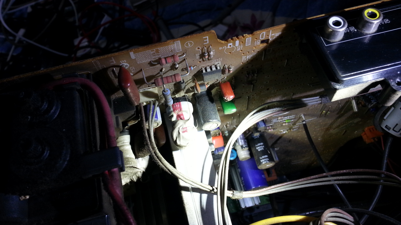

I'm sorry that I delayed too long in replying, Frankly speaking a few weeks ago, I came across another CRT TV(anam ck-29p8lt) in a recycling bin,And When I have brought it to my house, I just found that Its ac power cord already have been cut by someone,So I replaced its broken AC power cord with AC power cord of slimCRT TV(21fu1r-ns of 220 voltage) which I have tried to fix,and It seems that this 29 inch CRT TV flawlessly works!
But I'm still interested in fixing this slimCRT TV(21fu1r-ns of 220 voltage).
So I made primitive and clumsy capacitor discharge tool which made use of 2kohm 10watts ceramic resistor, So I discharged the biggest capacitor with this clumsy discharge tools,But To my surprise, This biggest capacitor still had 260 voltage before I discharged it...anyway I finally successfully detached PCB of this slimCRT TV.
And I luckly found MC059C diagram of below screenshot which which seems to be the same with 21fu1r-ns excepting for part of ic501 and ic661,ic751 and ic701.
I narrowly deslodered large heat sink of STR-W6754 regulator which is in the way for measuring carbon resistor in the HOT area(It was very hard to desolder this large heat sink with my soldering skill), Then I measured ohm value of all of carbon resistor in the HOT area(R801,R802,R820,R805,R804,R810,R812,R807,R805,R809).
and I desoldered some of resistor which seems to need precise measurement,It seems that all of carbon resistor in the HOT area have somewhat same ohm value with each resistor in MC059C diagram.
and I even desoldered DB801(TS4B05G rectifier diode) and test it with LCR t4 meter and Its voltage seems to be within tolerance
I cannot understand why most of stored voltage in the largest capacitor won't be discharged in circuit even after a few weeks.... In the last resort, I desoldered C802 capacitor(pcx2 335m mkp 0.22uf 275v film capacitor) and measure its capacitor with LCR t4 meter and DMM.
