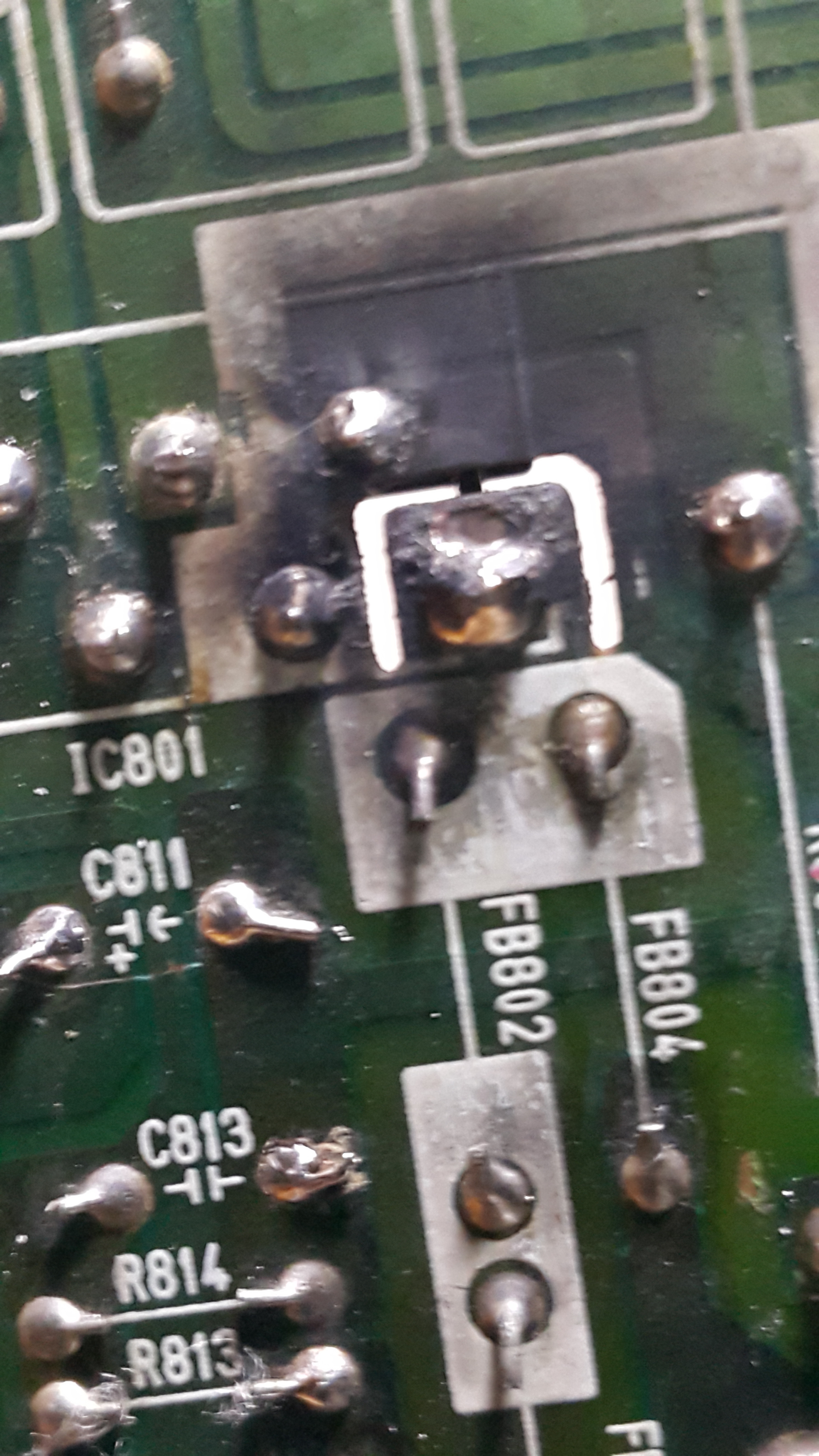

By refering to below tutorial,I tried to repair another 29 inch CRT TV(LG CN 29H3) which i sometimes have used for playing retro game console and It suddenly broke down a week ago.
I measured voltage of power regulator ic(STR-S6707) with switching on, which is a crucial component of CRT TV's PCB in HOT area.
https://www.electronicsrepairmadeas...er-supply-problems-smps.html?lr=1715042500018
I successfully measured voltage pin#1(collector 370-400DCV)#9(vccin 6.2-6.6DCV) of STR-S6707 with analogue meter.
But I noticed that when I measured voltage between the biggest capacitor(main filter capacitor),It was 300-320DCV,But when I measured voltage of pin#1 of STR-S6707 It was 370-400DCV.
In order to raise the accuracy of voltage measurement, So I tried to measure it with hioki CARD HiTESTER 3240 which my father ,who has already passed away, bought me more than 30 years ago.

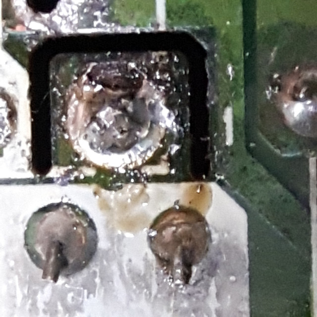

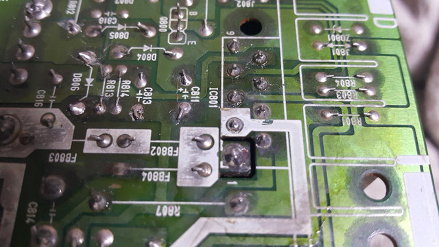

To my surprise,As soon as I placed hioki CARD HiTESTER 3240's black and red probe to negative pin of the biggest capacitor and pin#1 of STR-S6707,I saw big sparks from soldering point of STR-S6707(pin#1)
This big spark cause to peel off some of upper soldering pad(pin#1 of STR-S6707) like below screenshot.
It is screenshot After I finished to desolder STR-S6707..
And I doubt that this big spark would spoiled component(FB802,FB804) which is very close to pin#1 of STR-S6707.
I think that If I connect this PCB of CRT TV to cathode ray tube and switch on, There would be a possibility to malfunction or even catch a fire as high voltage(370-400DCV) pass through this damaged soldering pad(pin#1 of STR-S6707).
Should I throw away CRT TV's PCB which has damaged soldering pad of power regulator ic(pin#1 of STR-S6707)?
Or Although some of soldering pad(pin#1 of STR-S6707) have been damaged ,where high voltage(370-400DCV) pass through, Is it safe to mount STR-S6707 power regulator by soldering and continue to test it?
