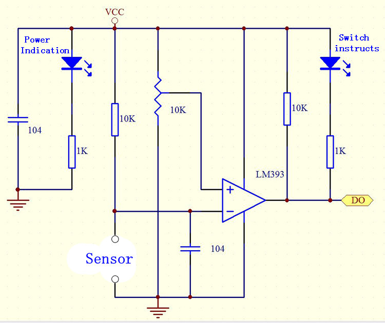

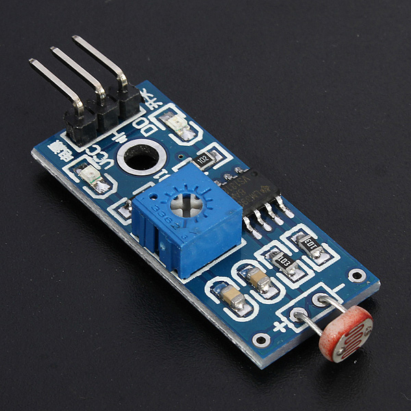

Also I found this guy for cheap: Light switch module Couldn't I use Digital Output of this to switch ON my transistor? They say it works on 3-5v I don't know why when it uses a LM393 which works on up to 34v, maybe because of the 2 LEDs on it? I would remove those anyways
Here is the circuit of it:

You could use that device.
  1. It has no positive feedback, so it may not switch cleanly, although it will switch on and off quite hard.
  2. The low output may be insufficient to turn off the transistor (and it is low when active). Can you use a PNP transistor between the +ve supply and the load instead of an NPN transistor in the ground lead of the load?
  3. It is marked as 3 to 5 V because it is designed for use with microcontrollers that typically have power supplies between these voltages.
  4. Yes, if you were to retain the LEDs you would need to change the series resistors to provide a lower current for the LEDs at higher voltages.
