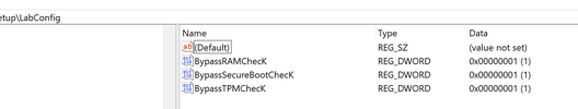

There are several ways;
1. upgrade with reg keys added to determine the max level to update and with bypass keys. using option to keep files and not clean install.
2. get the torrent for the iso for win21H2 with no TPM , save it , open using 7-zip to see and run setup.exe or use Rufus to burn to bootable USB or
3. use Rufus.exe 4.9 + change select to DOWNLOAD then click it and select EUFI SHELL 2.2 then select any release of win11 like 21H2 with the above instructions
But to customize; I use win11 debloater, winaero tweaker, explorer patcher, Ultimate Windows Tweaker for a couple shell tools. Then disable Windows updates, Windefender, add folders to exclude, I don't like bloated Edge and use Brave browser
This assumes you have some experience doing these kinds of installs. It takes a couple hrs. and I used 16GB Ram but preferred 32 GB and at least 500 MB SSD
Search web for better instructions:
Computer\HKEY_LOCAL_MACHINE\SOFTWARE\Policies\Microsoft\Windows\WindowsUpdate
Computer\HKEY_LOCAL_MACHINE\SYSTEM\Setup\LabConfig
