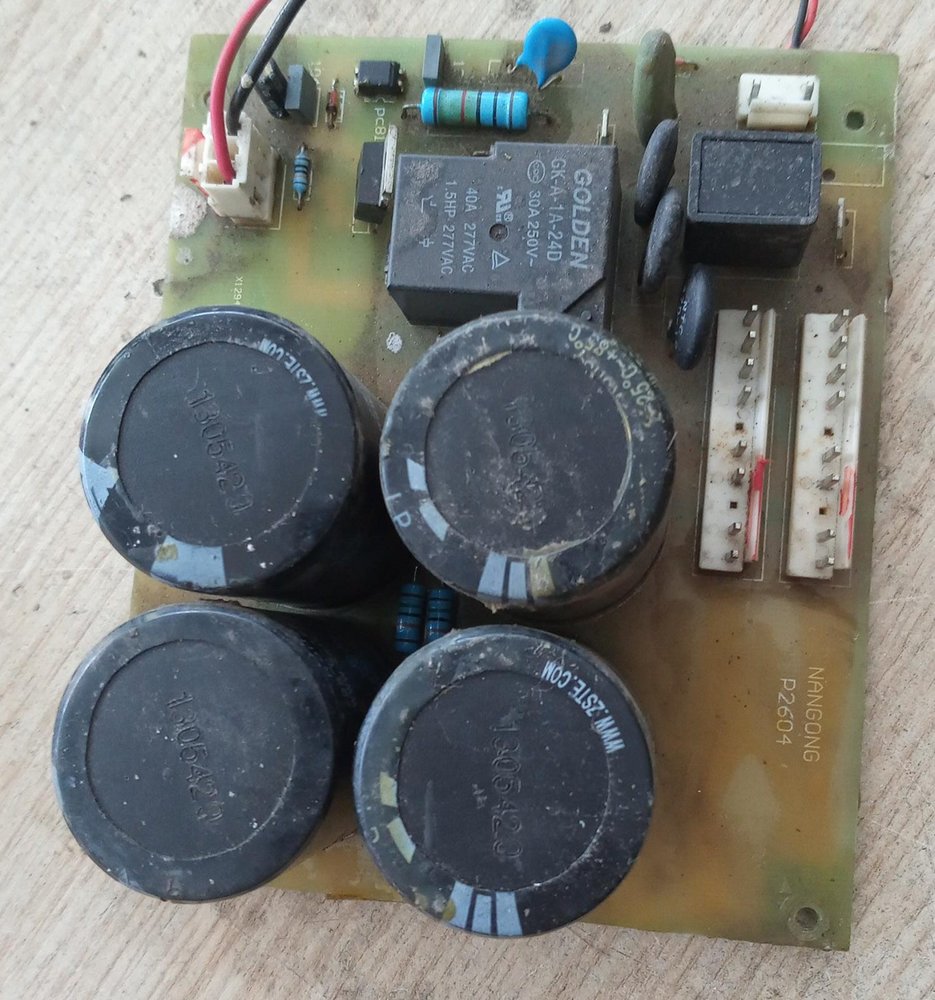

The diodes I changed are on the Transformer Rectifier floor:
5bf221d7-be2e-4f9d-85d1-a7a1520e8641-jpg.358542

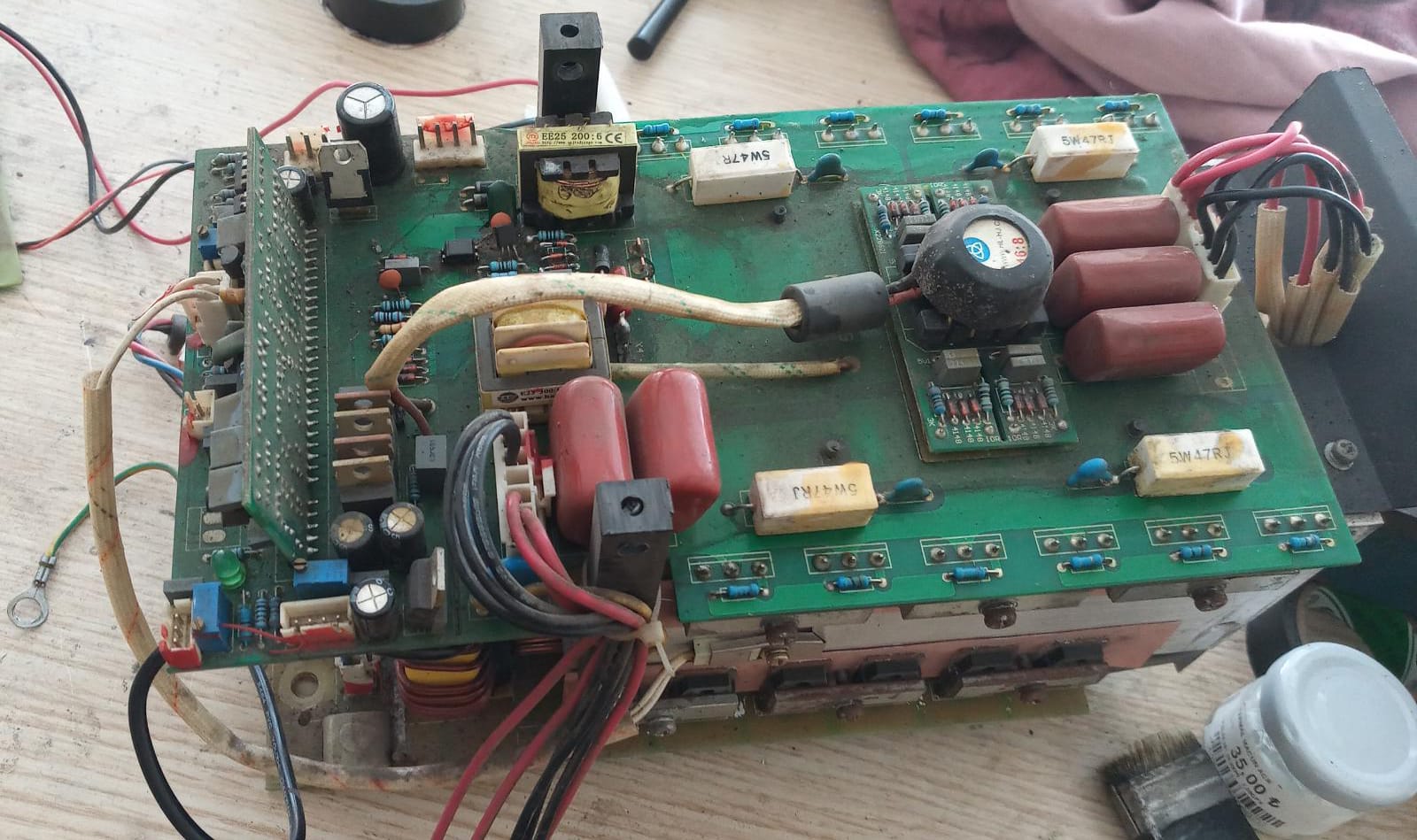

Pictures of the machine:
be38ba80-6287-48f0-856e-3d7d590d65c5-jpg.358543
dc373bc8-0485-401c-a7b7-e29784d3e868-jpg.358544

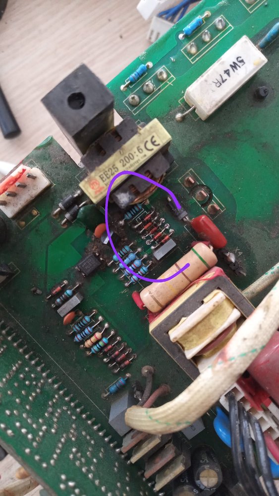

Are the diodes you replaced inserted in the correct orientation? Diodes don't just 'explode' without good cause and something else has quite likely gone wrong that's yet to be identified. Show the area with the blown diodes in close-up plus show the rear of the board where they are situated.
How did you identify the diodes as 1N4148's? Do you have a schematic for the unit?
I'd suggest you also give the boards a thorough clean using IPA - the crud on the board surface may be conductive......

I count 5 diodes adjacent to eachother...think you'll find one would possibly be a zener.
Without more detail, hard to say.
Wouldn't expect to see 1N4148 as rectifiers there though.

I repaired a 3kW charger/inverter a while ago that used 1N4148's as a bridge rectifier to monitor line voltage (via a low voltage transformer secondary) - one of the diode shad gone o/c and the resultant voltage caused the output voltage of the inverter to be wrong.
The images show a transformer but I can't determine if it's SMPS or 'regular' (not that it makes much difference given the high speed switching the 1N4148's are capable of) and the circuitry does look as if it will generate a signal based on whatever the transformer is outputting/monitoring. We need to see how the transformer is connected (input and output) plus a closer look at that adjacent transistor...
