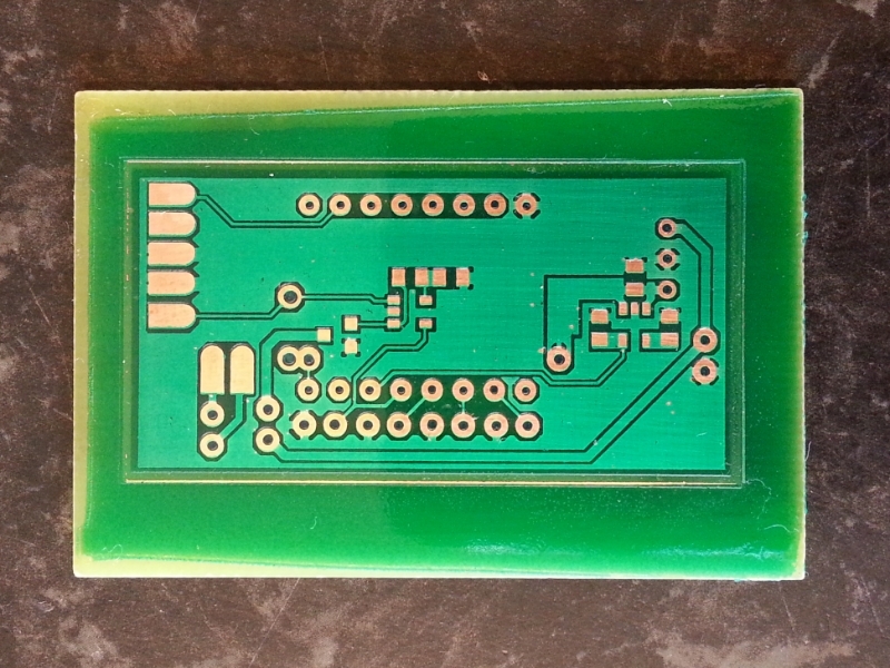

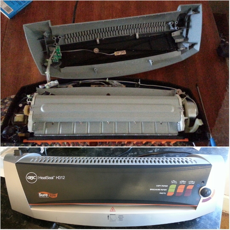

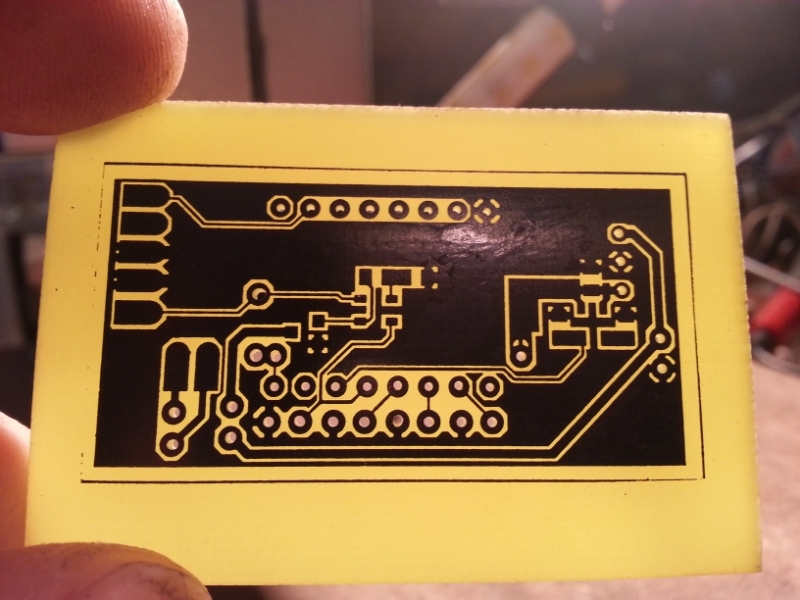

The ones to go for are "hot roll" laminators, the fundamental difference being that they heat the rollers internally which provides a much more efficient solution.
I have a GBC HeatSeal H312 which I got for cheap on ebay and the only mod I eventually made to it was to cut a part of the housing out to get better access to the rollers when making small boards.
In fact, I was curious to see how thin I could successfully make track widths using it for toner transfer before things went awry, so my last board had some .2mm traces on it which is as fine as I've gone so far:
(I have to turn the heat down for resist films)
