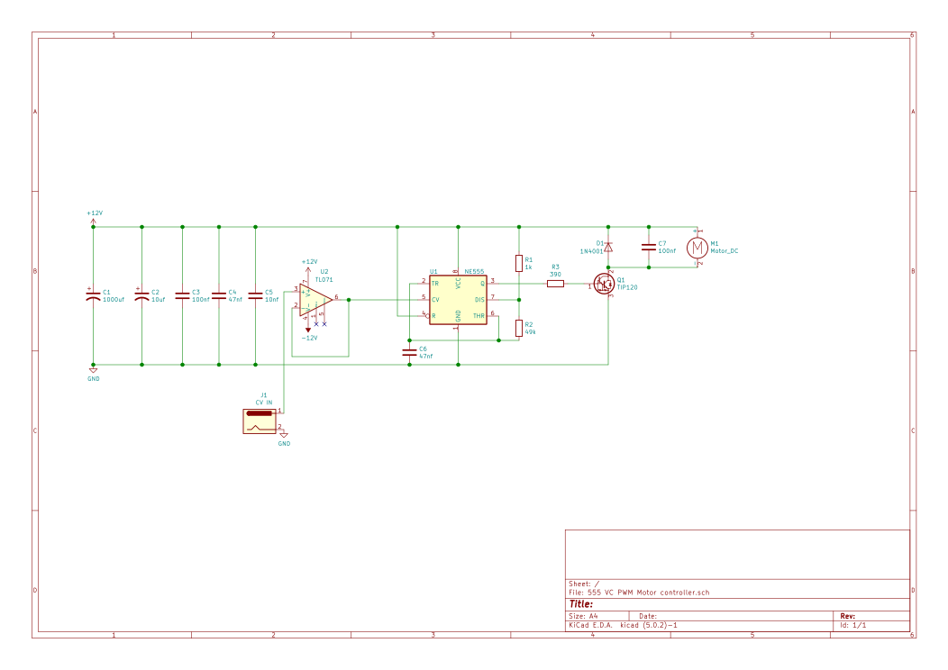

Hi all I wish to learn how to use Kicad. I have been doing tutorials via Kicad and watched some video tutorials. I have done a few smaller tutorials like learning simple led circuits for example.
I would like to see if i can go though the process with a Voltage Controlled PWM circuit I am using quite a lot and would like to expand on in the future, but for now I'll keep it as simple as possible so i can learn and keep things less complicated. I figured it's probably best for me to post a schematic first and see if my Kicad schematic drawing is up to scratch (I've not paid enough attention yet to learning to draw schematics, so criticism is most appreciated).
Thanks in advance

You will also have to define/place the +12v -12v and GND as power points/sources
Look in the Power directory and you will see a few xxx_FLAG symbols.
This is if you wish to make PCboard and Gerbers etc.
The Kicad forum is also useful.
M.

Thanks Minder, I did get a few errors correlating to them when running an electrical rules check but couldn't understand the meaning of the messages, I will edit as you suggest in my workshop in the morning and run a rules test again.

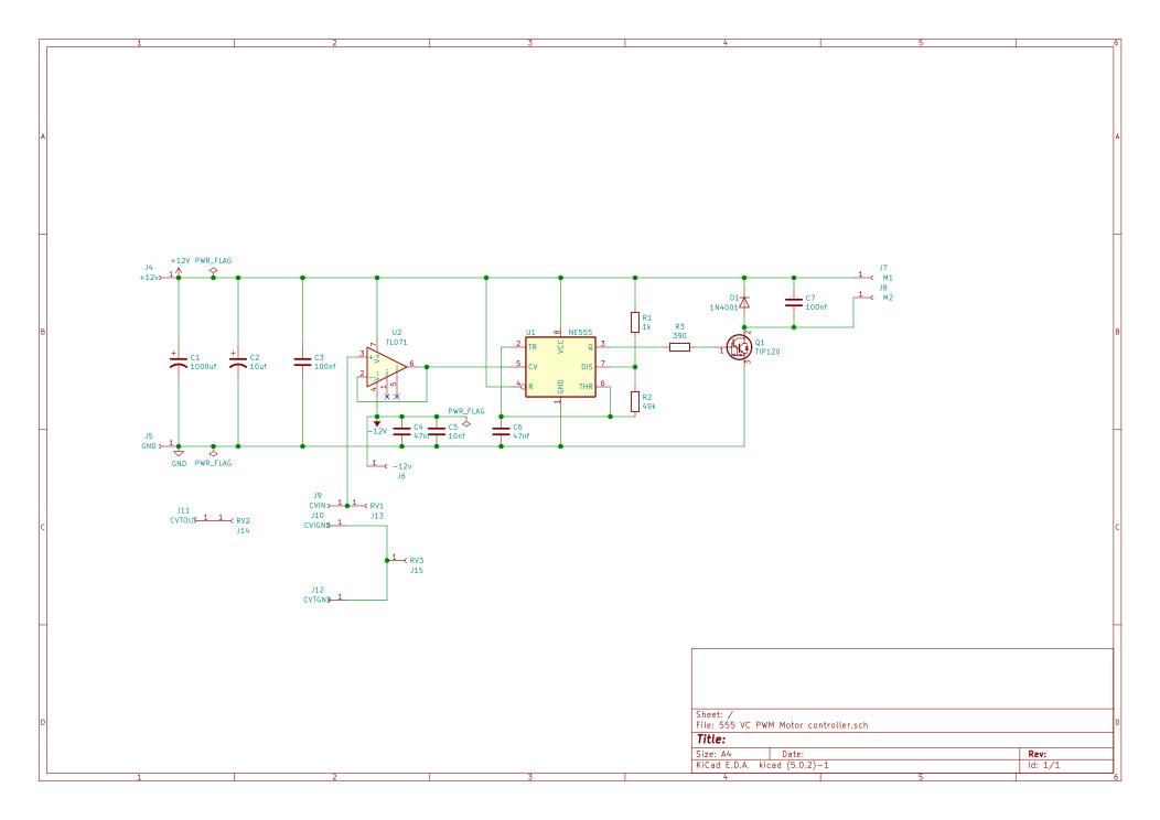

Took me a while to work out why I couldn't find the SWG file to convert in gimp to a JPEG so to post to imgur, yesterday it took me 5 mins....just need to better at organising project folders.
anyhow, here is the updated schematic, it passes the electronics rules test :)
I've switched the motor for an output jack as this circuit is intended for a modular synthesizer. I've also added the CV through part of the circuit with attenuation. The full module I use at the minute has two drivers per module, each with CV in, Cv through, CV through inverted (utilising Tl074) and motor attenuation via a pot... but I'll get though this circuit first before attempting anything more complicated.
Also I realised that C4 and C5 were in the incorrect place so have moved the to the correct place now.

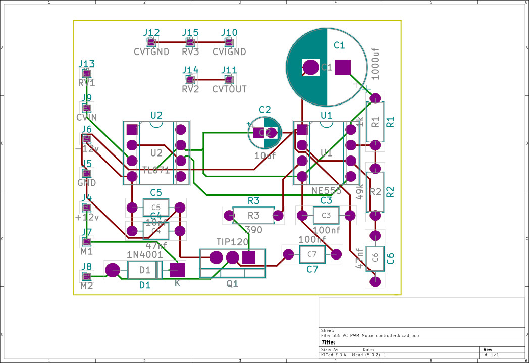

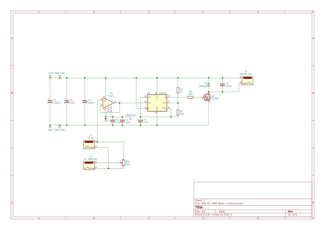

Hi, I got further today and yesterday, realised a few errors I was making etc. Anyhow, I've updated the Circuit drawing 'Eeschema' so I'll post that here first. I realised if I wanted individually labeled circuit tags for panel wiring I needed to assign individual connectors to the relevant parts of the circuit, in cluding the panel mounted potentiometer which is now assigned as rv1-rv3.

And here is a jpeg of the PCBNEW layout. I expect I'll be misunderstanding quite a lot here in terms of layout.
