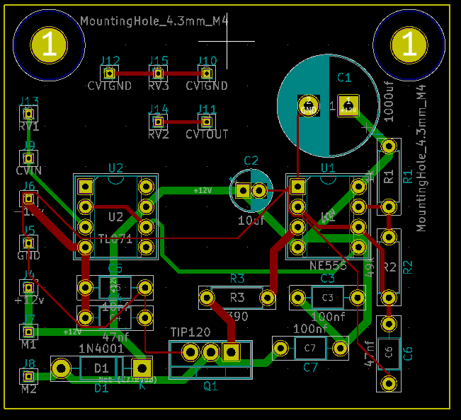

I usually place mounting holes in the corners.
Also no ground plane?
I use Greenshot for capturing JPG's.
M.
Ahh ok, I didn't realise I'd need to have a ground plane as all the ground connections are connected?
Yes, mounting holes! I'll add them, thanks, that would have been a really annoying thing to forget!
I'll look into Greenshot, thanks, "edit" I downloaded greenshot and it's perfect, thanks!
Darren
It is not compulsory ;)
But most cases advisable for most circuits..
Fortunately the one I forgot it on, was very low freq signals and minor circuitry.
M.

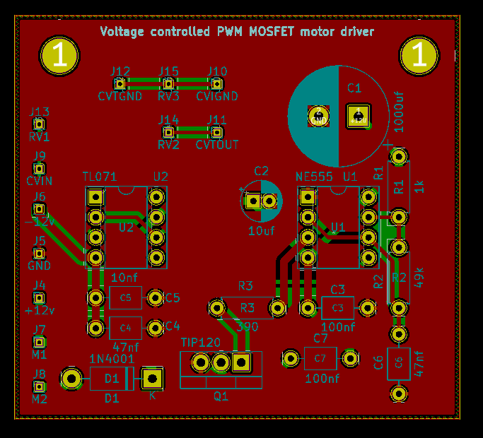

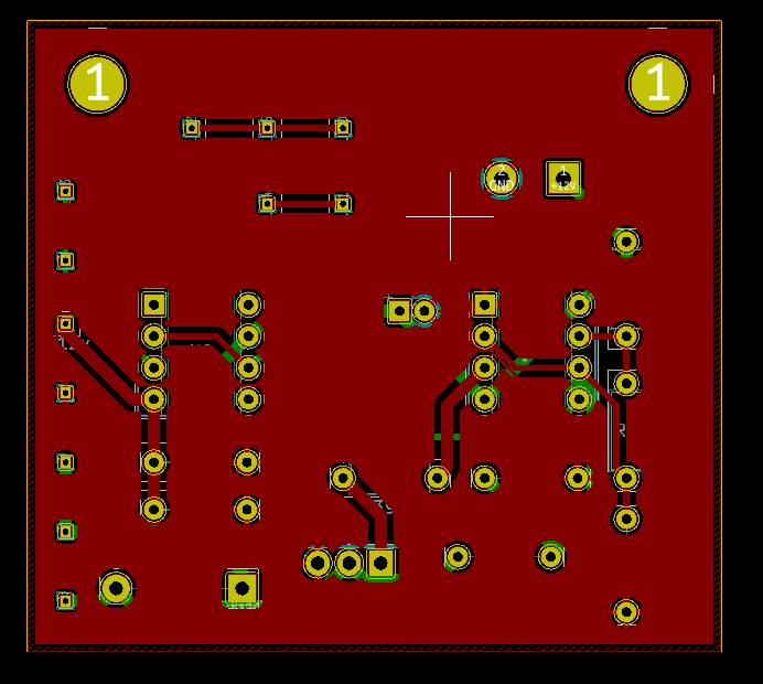

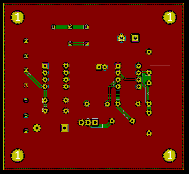

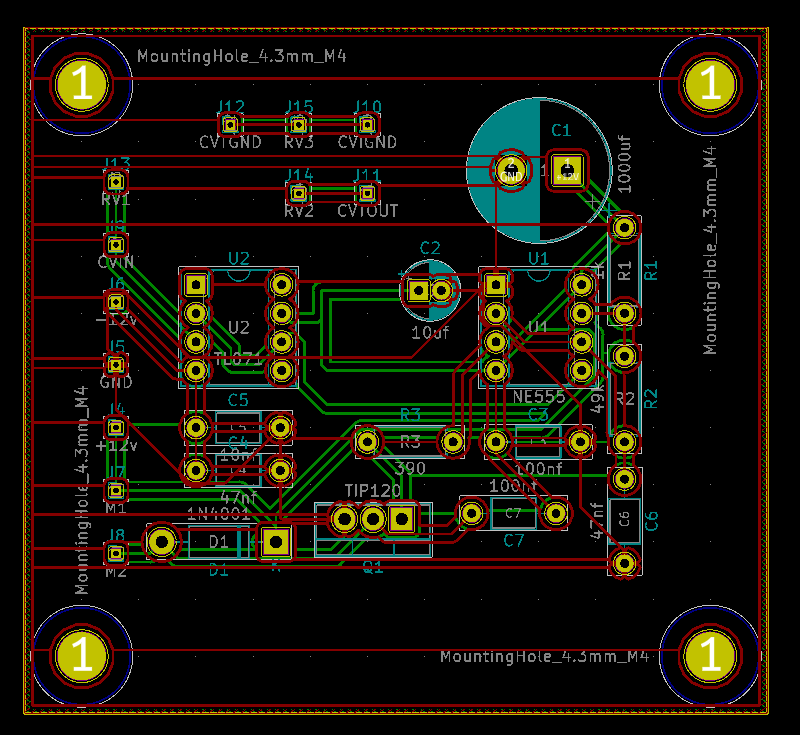

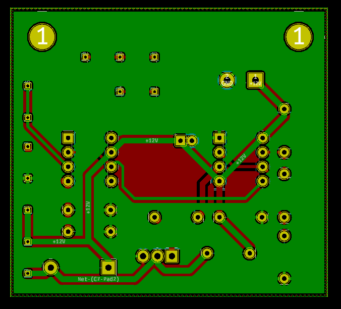

Hi, got back to kicad today.
Here is how the ground planes and mounting holes are looking. I wasn't sure which image was needed, so posted three
This one is " Show outlines of filled areas only in zones"
This one is the 'back layer' filled zone before i added the front layer
And here is the front layer's filled ground zone

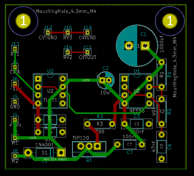

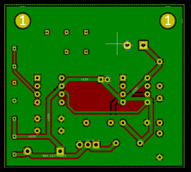

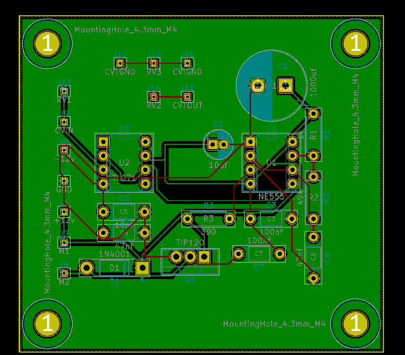

Here's the updated pcb new file without ground plane and new trace widths, I used an online calculator, https://www.7pcb.com/trace-width-calculator.php. The motors I am using have a stall current of 1.5a and the online calculator suggests a trace width of 0.942mm. I made the traces relating to TIP120/motor out all 1mm wide, and both the +12v and -12v supply lines.
I changed all other traces to 0.5mm, no other reason than 'not to skimp'. I couldn't find any online material that suggested the 3khz trace output of 555 needed a specific width, but then i'm certainly not fully understanding what I am reading, lot's of new terminology.
I also got rid of two of the mounting holes as I prefer to mount pcb's vertically

Thanks
Then I clicked the design rules checks and got a whole bunch of errors, so will work through them now
darren adcock
Sep 26, 2016
463
Sep 26, 2016
463
Ok that was a little easier than i thought it was going to be, just hadn't paid attention to traces being too close to pads as I'd relied too much on kicad deciding where the traces should go.
This passes the design rules check.

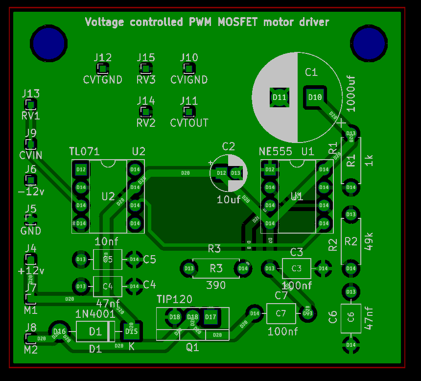

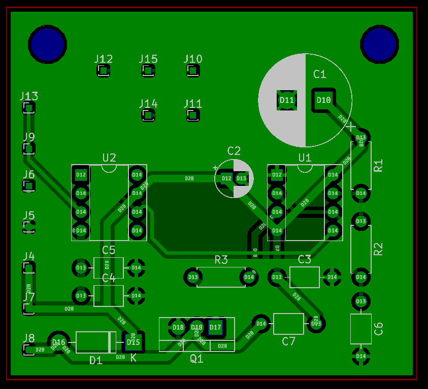

Am a little confused. How come in pcb view, when i select front view and front silkscreen layer i see all the text I'd like on the final pcb, but when i view in Gerber view I don't see all the texts, just the reference for each component?
pcb view
Gerber view

The next step is to ZIP or RAR it and send to the board manuf, PCBway etc for their approval.
They will tell you if it comes up to scratch.
