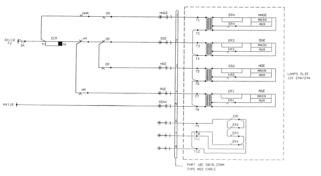

I again have to apologize for the fact that I explained this extremely bad.
As you mentioned you have one Lamp proving relay (Or current proving realy) for each signal head. This means one relay for your red, yellow and green in one, just to ensure that a lamp is at least lit.

Only one proving relay to service two or more lamps? How exactly does this work? Are all the lamps wired in common to this one source of power (through the proving relay coil) and then switched independently on their other end to the power supply common to determine which light will illuminate?.
I guess that makes sense if only one lamp at a time is illuminated. Here in the USA most road traffic signals use an intermediate step when switching from green to red: first green, then green and yellow (or orange), and finally red. There is often another delay switching from red to green for traffic going in the crosswise direction, resulting in a brief interval when the traffic signal indicates red for both directions. This is probably never done for railroad signaling. So, if you are moving your croc-clips from one controller output to another for test purposes, just one circuit as shown by Chris in post #37 should work fine. Or, as you noted in post #36 just a resistor will work as a dummy load. Solder some test leads to it and add croc-clips to the ends of the two wires. You're in business! Grab the resistor with asbestos insulated gloves after it's been on for awhile.:p The heat can tell you whether there is current flow, albeit with some delay.
So, @lxlramlxl, which circuit, if any, are you going to build? Is this going to be a commercial product, like those "hot" circuit probes, for which you are gonna rake in big buks (or pounds sterling)? :D

Here is a circuit head circuit, it's a very old one but everything is pretty much the same other than the Lamps themselves since we have turned to LED arrays now.
Edit: if you're not familiar with the namings its; HHR is your second yellow, HR is your yellow and DR is your green.
The reason that the secondary yellow isn't proved is because if the lamp fails then it will show a more restrictive aspect (Single yellow) so is "safer"

There is nothing in the signal head to indicate that the ECR is down other than having a black signal (no lights)
The ECR status is fed back to the signal box where the signaler will get an alert, he would also see on his panel that there is no lamp lit.
The only problem with this circuit is that all of the LED's will light up regardless of where you croc on for your voltage, which is probably go with your first suggestion of the single LED.
If you can understand the circuit diagram for the signal head that I posted in #43 it shows that each lamp is separately fed. The ideal situation is where you croc on to each link for the respective lamp.
If I really did want separate LEDs for each lamp then I could just replicate the circuit you posted in #37 3 or even 4 times. What is the need for 4 diodes? Is there any advantage of using the circuit in #37 over the one posted in #33?

This schematic seems to indicate that each LED array is switched ON/OFF in the 12V side of the transformer through ER-1 to ER-4. In this case the LED array currents are reflected back to the ECR (110VAC Primary) side of the transformer. If your goal is to provide a dummy load on the secondary side of the transformer you should have stated that. Even if that's the case I don't see why you'd need more than one dummy load because you can connect it to each secondary circuit one at a time. If you want the ability to load all four transformers simultaneously then yes, build 4 dummy load circuits, each with its own single LED as I drew in my first Diode regulator circuit.
One note here and I've stated this before. In order for these dummy loads to work and NOT activate the LED arrays all the relays marked ER-1 through ER-4 must be OFF.

I did say in the post with the picture of the signal head circuitry that it is very old 20+ years. It was just to show Hevans the relays involved and how the circuit operates since he seemed interested.
These days there is no transformer and just 110V fed straight to the head. So hopefully no pond crossing is required!

As I said it's an old circuit and ER1-4 isn't there since it was to prove your main filament hasn't failed, which you obviously don't have with LEDs.
Like I said that diagram was for Heavens to have a look at since it seemed like he was curious with how it's wired in the UK, which is similar to what was posted bar the transformer and the ERs.

The switches was meant to represent links;
Which are used to isolate the power to the signal head, show in the circuit posted in #43. Specifically these
As you have stated in numerous previous posts Chris that I only need 1 dummy load and I have agreed with you I'm not sure why you are still arguing this point?
I made this 10x more difficult that it needed to be with shitty explanations and unclear diagrams, so again I apologize. I'd also like to thank everyone for all your assistance that I've had regardless of the problems that I mentioned.

lxlramlxl, thanks for the explanation. It clears things up. Sorry for being so damn persistent. I just wanted to be sure that I understood that you understood what I understood! :p
Not to beat this topic to death but I think this is worth pointing out. If you're goal is to determine that the ECR does in fact trip at it's 'minimum' rated current you'll need more than what I gave you.
