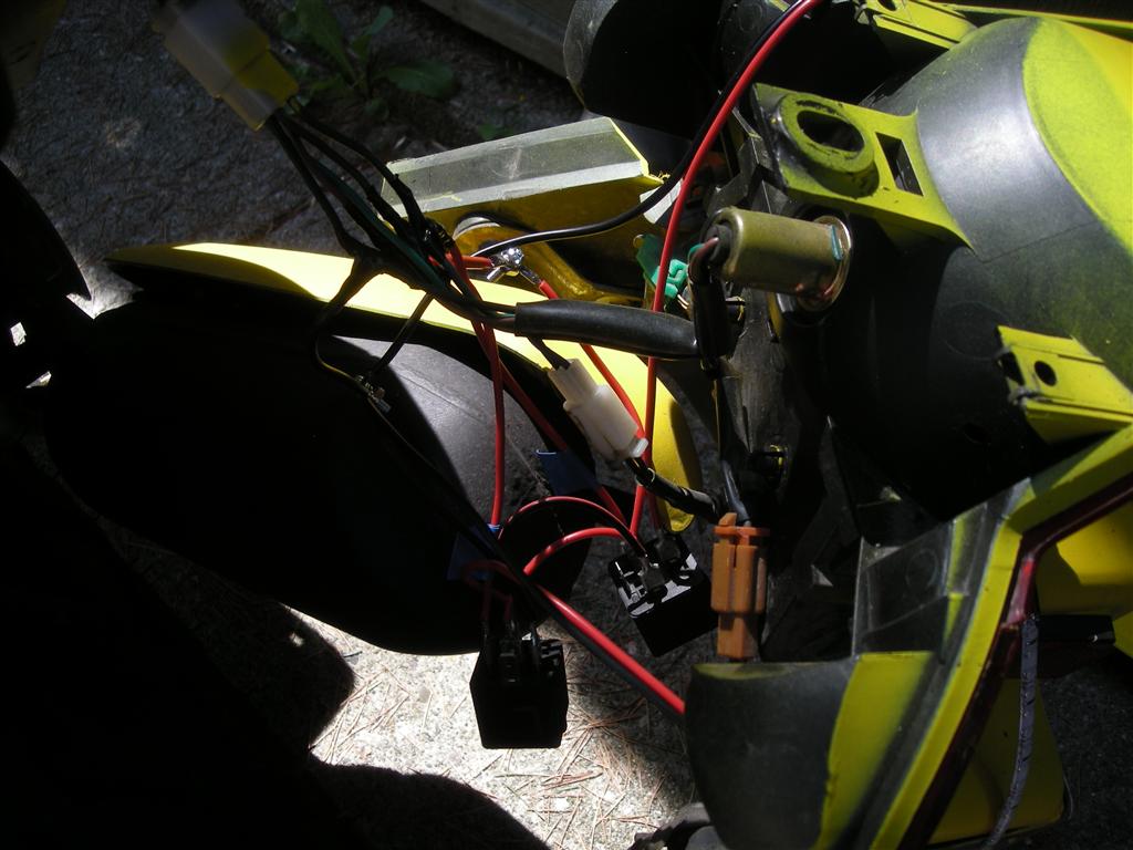

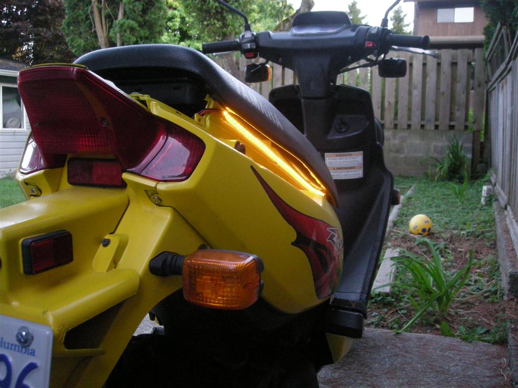

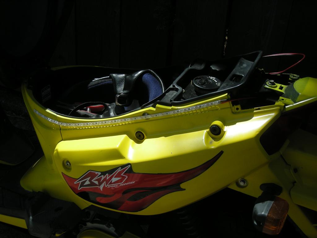

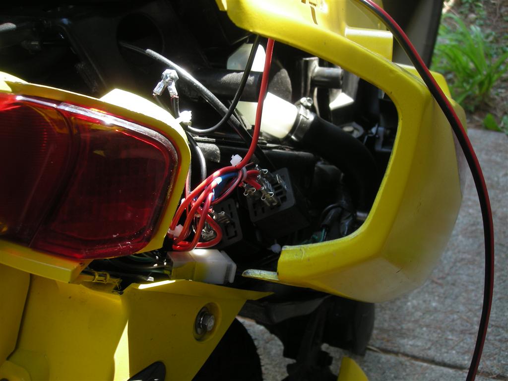

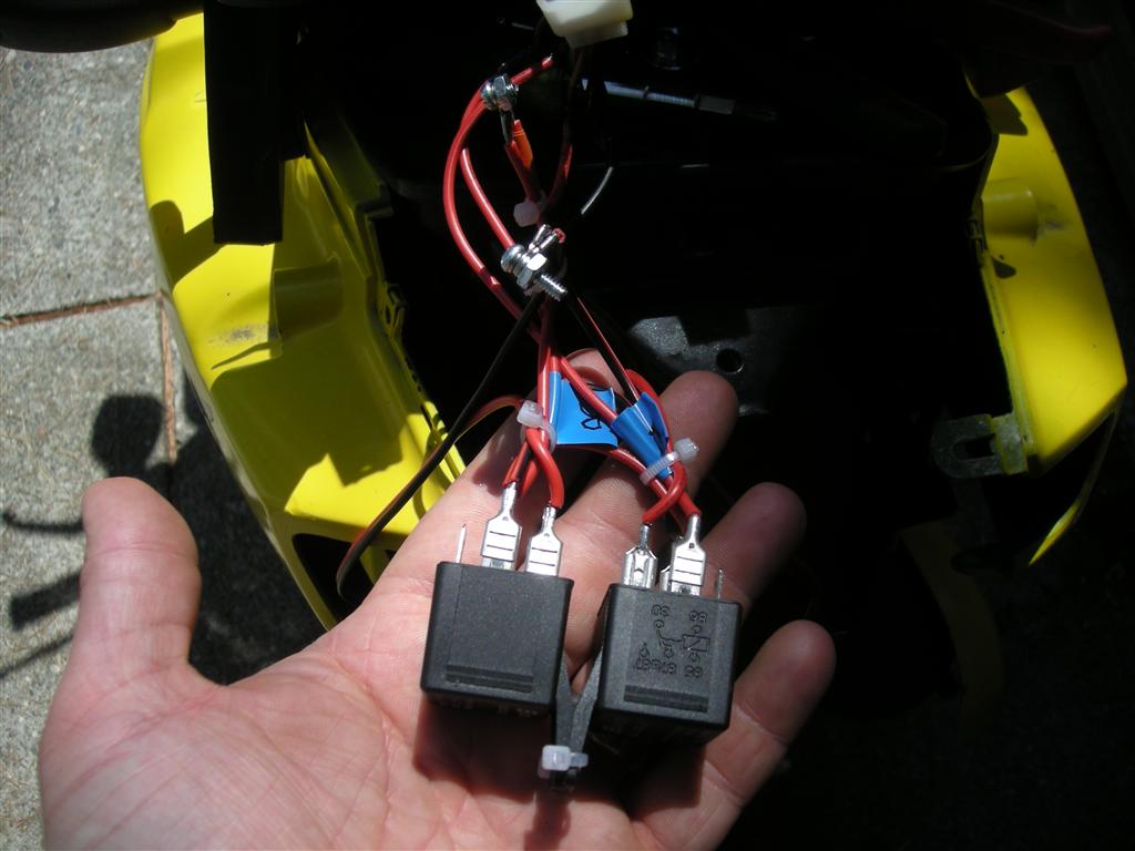

Got it working. Scrapped the solid state components. Couple of 12V automotive relays and some crimps later, got them wired up and working first try. I've uploaded a video and a couple pictures for anyone who's curious. Thanks for the suggestions!
What a rats nest hey?
Close-up of the relays, all wired up and ready to stuff into the scooter.
Perfect amount of space inside the right fender to slip everything in there.
LED strip installed on one side. Self-adhesive backing, so simply peel and stick.
Under seat shot of the LED strip lit up.
