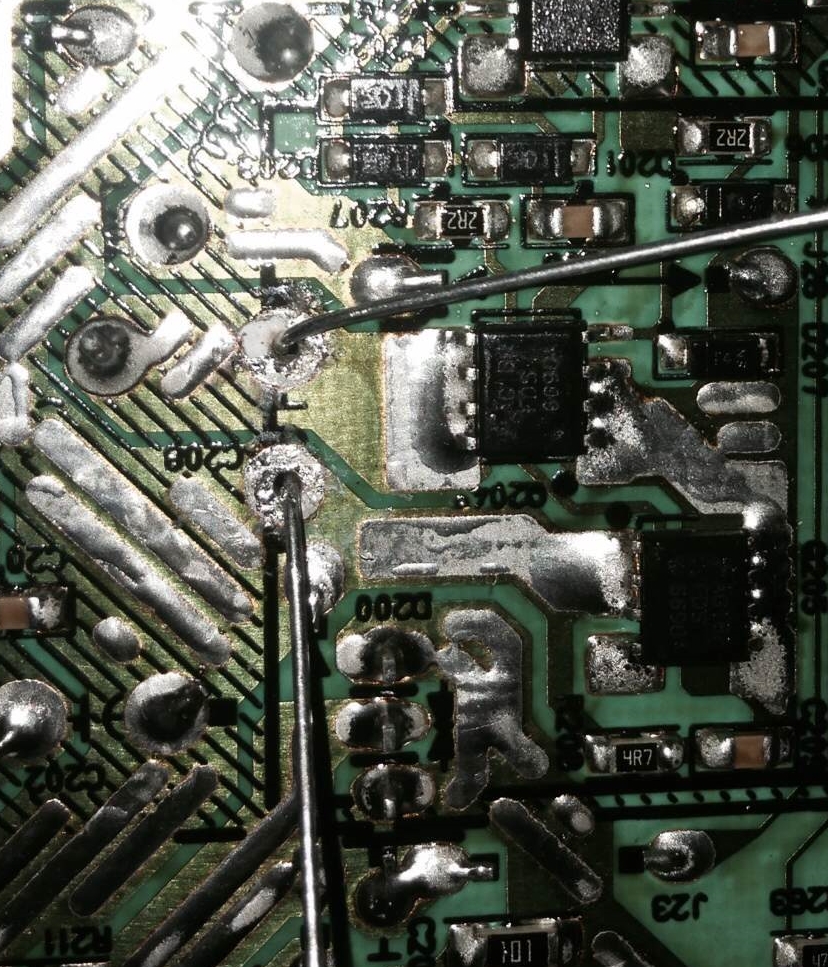

My LG 32LC2D 32" flat screen has been giving up for a while... this morning it finally gave up completely.
Research told me that the issue was most likely a bad electrolytic capacitor, so I decided to channel my Grandpa and fix it myself. As it turns out, channeling my grandfather did not channel his soldering skills.
I messed up the pad a bit, and my total inexperience in electronics tells me that I do not know enough to feel confident in moving forward. I am linking the picture below.
Does that look like I can just flow a little more solder over it, trim, and go? Or do I need to figure out how to repair that little bald spot somehow first?

This is half as bad as it looks. Take care not to lift off more of the pad when you re-solder it. Trim the wires before soldering. Trimming after soldering will stress the solder joint.
Heed the orientation of the electrolytic capacitor!

The bald spot won't be an issue, enough of the pad remains.
leave the leads straight when you solder them.
Ensure the replacement is appropriate and the polarity is correct before you solder.
good luck

Okay, PHEW!
Thank you so much for the quick replies! Glad I didn't mess it up too bad!
I did double (and triple) check the polarity, and I only have them bent at the moment to hold it in place. I removed a 1000uf 16v 105c Capacitor, and put a 1000uf 25v 105c Capacitor in its place. Everything I read said that moving up in voltage was better if possible. Hopefully that is true?

Just thought I would update and let you know that the repair worked! Thank you again for the assistance!!!
