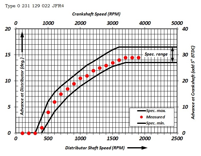

On a side note how would the ignition timing work?
I see from the instructions that they set the timing to about 30 degrees BTDC so I'm assuming that the circuitry will detect the pulse from the hall sensor and using the time between pulses will either give a long delay at low revs to set the timing to within a few degrees of TDC before firing the spark or lessen the delay until you have the full 30 degree advance for higher revs.
Would make an interesting project using discrete IC's rather than an MCU.

There is no advance /retard on those units.
That's going to make starting damn near impossible. Every time the piston is rising on the compression stroke the spark will fire and never let the piston get to TDC.
There are millions of engines out there that use the fixed ignition system.
Usual placement of ignition points or whatever is around 28 degrees btdc.
Usually they are of a type where a particular rev range is required e.g. water pumps, rotary hoes, timber saws, on and on and no, it's not a problem for starting.

So the ASE classes I took to get my Master Certification were all wrong?
Going to ask for a refund.
Bluejets
Oct 5, 2014
7,374
Oct 5, 2014
7,374
That's advance/retard, not fixed ignition.
No, not wrong, just a different application.
Motor vehicles and the like require the best ignition points to give maximum performence/ efficiency over a wide range of speeds and loads.
Not so with the applications I outlined earlier.
