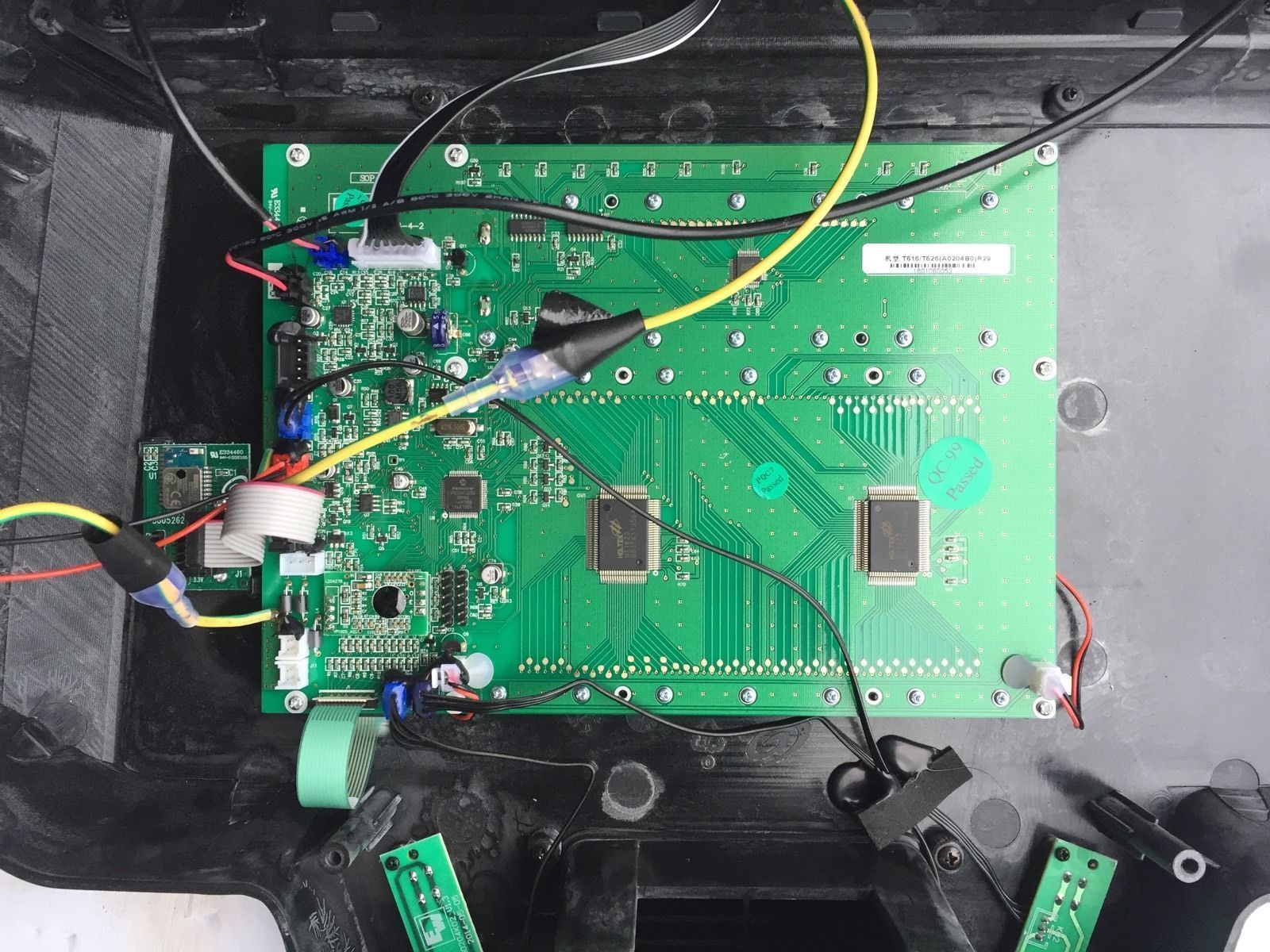

I need some help with basic troubleshooting to figure out why my treadmill console is dead. When I apply power, I can see the red power LED come on on the lower control board, there is also an "Info" led that comes on briefly then goes off.
However, the control panel at the top is dead and has no visible signs of life.
I think my first task is to check to see if I'm getting power at the PCB of the upper console, correct?
I have a multimeter but I need a basic introduction of how to proceed to figure this out.
Thanks in advance for your help. Pics are below:
Here's a shot of what the panel SHOULD look like when turned on:
Here's what the pins looked like after the connectors were accidentally pulled off:
And here's a look at the board after the pins were straightened and the connectors put back into place. I oriented them so that the snap side was on the side where the stencil shows an open gate. Note, J12 is the fan and I've just removed that for now. J14 was open and those pins got bent by J12 when the connectors were snatched by the weight of the control panel flipping over during transport.

Treadmill is a Nautilus T614. Here's a wider shot of the console board:
kellys_eye
Jun 25, 2010
6,512
Jun 25, 2010
6,512
Is there anything connected to J14?
Is the flat ribbon cable (bottom left corner in lower pic) seated straight? Looks a bit skew-iff to me.
No. Nothing is connected to J14 There are no connectors coming from the harness or board that fit it. The main harness is connected to J4 and it only has a single row 5 pins. J14 is double row 5 pins. I have no schematic to follow but that's my best guess.
Its just the pic I think, here's another angle:
FWIW, here is a model T616 board showing a very similar configuration (I took this pic from an ebay listing). J14 appears to be connected on this model to a ribbon cable, so I believe T614 did not have this option:

After a bit more research on how to test/troubleshoot basic AC to DC power voltages from the power supply, I have the following results:
The input power, switch and reset. Note: the reset button does not click at all, it just depresses with no resistance and does not appear to have any affect on the control board. The steady red LED remains unchanged when depressing the reset button.
Here's a shot of the power supply feed to the main board:
Here's a closeup shot of the power connector, the glue obscures the labels, but it appears to be:
GRD, ?XD, ?XD, +12V, SW
And finally, heres a shot of the power harness connection at the console where I'm attempting to check the DC voltages of the pins. I've got my black probe on the left pin (GND) and the measurements are:
GRN, ?XD = >100, ?XD => 11, +12v = > 12, SW => .49

?XD will be TXD and RXD (Transmit Data and Receive Data) respectively - meaning the board 'talks' to some other part of the device.
The 'none tactile' reset switch is normal. It would 'click' if it had tripped out and you pressed it to reset it.
1. Check all fuses
2. Measure all supplies
If all the fuses are good and all the relevant supplies are present then the fault is 'further along' in the system i.e the controller or motor board. Note that some faults may cause the power supply to automatically shut down making you 'think' the power supply is faulty when it really isn't.
What you then need to do is disconnect the outputs from the power supply and connect them to a resistive load to see if the power supply can deliver the required current and prove that it is ok in itself.
BUT.... some power supplies talk to the rest of the circuitry and might just shut down if the other part doesn't talk back - which it may not do if you remove the power supply to it.....
By now you should be getting the idea that fixing these things isn't quite as easy or straightforward as you might imagine.
As per the other thread, you would be better off swapping out boards to isolate the section that's dodgy and purchasing a working spare board. Quite often this makes the repair more costly that the equipment is actually worth i.e. Beyond Economic Repair (BER) and you have to make commercial decisions based on those results.
You could spend time and money learning the requisite skills to fix them yourself but that could take (literally) years. Or you could employ someone with those skills and cost it in.
Sadly, and inevitably, some goods are just not worth fixing for the majority of people and people with the skills to fix them cost money. Catch 22.

Problem solved. I'm a dumbass! After taking a closer look at the lower board's harness connector that feeds up to the console, I realized that it connected the exact opposite orientation as they way I have it connected at the display panel.
After turning it around at the display panel, voila, the damn thing works!
Sorry for the wasted time guys. I did learn a bit about using a multimeter and troubleshooting a console power issue. Every failure is a learning experience.

Dave, that's an extremely keen observation you made. I thought the same thing when I first looked at the board to mate up the connectors to their spots. First though, let me clarify. All the pins were bent when I received the machine from the guy I hired to deliver it to me. All the connectors came off the board due to the screen being loose and flipping over during transport (or at some time during the delivery)
Here's what I think happened:
My first observation was that all of the pins on all impacted connectors on the board, were bent in the same direction, towards the bottom of the board - you can see that pretty clearly in pic 2 of my opening post. So that led me to believe the board flipped over in the opposite direction and caused the disconnect.
It appears that when the board flipped over forward, tensioning the wires to max and pulling the connectors fully off the board, the connector adjacent to J14, which is J12 - the fan connector - impacted J14's lead pins bending them. It also makes sense because the only pins on J14 that got bent were the ones closest to J12.

The keypad is a sticky-backed printed keypad with the button matrix connected via that clear, flat, green ribbon that I thought was off-centre.
If there is more than one key that isn't working it could be that there is a break in one of the tracks of that ribbon.
Have a good close-up look and see if you can see anything untoward - flex the ribbon slightly and look for breaks.
OK, here's that pic again. I'll pull the panel and give it another look. Should I pull the ribbon connector off to check it? If so, I haven't pulled one of these before. I'll need to google the procedure to make sure I don't break the thing.
