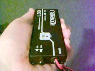

I am not sure on a little issue, i have a small 25 watt linear RF power amp running on TX only, temperature concerns, or are my worry's needless.
Operation at full rated power the heat sink body is reaching about 80 degrees C.What i am wondering is the temp fine, oh i cant find the spec on the units safe temperature limits, anyway the SWR of my set up is less than 1.2 on the SWR meter, so reflected RF energy is being kept with in the units operating parameters there, but the unit is only small, do i need to add extra heat sinking, i dont know.
The rated supply voltage is 13.80 volts, i am running it at 12.00 volts, so very slightly under powered.
A lot of power transistors can operate above this temperature, that temperature observation is the case and not the junction temperature, i cant operate the unit and get a junction temperature, enclosure etc.
Can anyone advise on the safe area temperature of this 25 watt linear RF amplifier. are the 80 degrees C typical and normal, i am expecting heat, as it is a power amplifier, and the case is extruded aluminum. So in summary will it serve a useful life at this operating temperature, i am not looking for any 100% guarantees, more a sensible operational life, the unit came with spec on input output power, but no in depth data, i will post a page link of the unit, in the hope some one has some ideas.

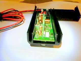

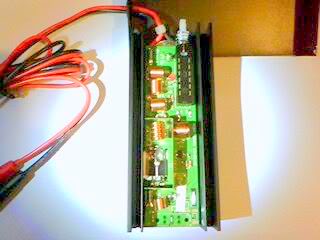

Can you post a picture of where those amps are? I'm rather curious considering the space constraints.... maybe we can think outside the box :)

Hi Matt. Not sure what you mean where they are. Its a unit conected to my radio via input output 50 ohm RG58 cable via PL259 plugs into SO239 sockets on the unit, i can open one up and post pic's later on the pc, plus a pic of the unit in situe connected to the radios RF output. I will get the pysical dimmensions of the unit as well. maybe these models are meant to run hot, ive tried to see the transiators model number type but its obscured bit of a pain as that data would have helped determine temp.

Yes, sorry, I was referring to the internals of the unit in question, just to see what kind of constraints you were working with.

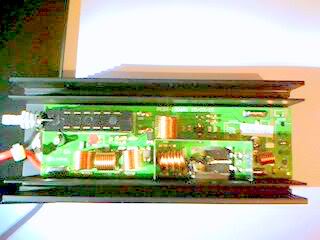

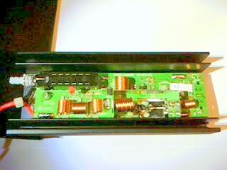

Hi Matt.
Not sure if my images are going to be brilliant but its all ive got at the minute, other than 35mm SLR's etc not digital.
Any way it worth a try on posting the images. :)
Might give some insite to better heat sink ideas. Not very clear but there are the two SO239 solder socket joints, melting these for removal might damage some of the SMD components from heat, there are some close to both joints. I have two units, the plan was me Mum was going to use the other at her place, but ive got to get round her using a small antenna and running power in a flat / apartment, ive tried and blotted out her TV on TX oop's, so not one at hers for now, i can talk to her on the allowable 4 watts. The output power transistor is clearest in the last picture in the shielded box.

To try and get enough clearance for bolting a heat sink on presents a problem or two, the machine screw heads that is, i am contemplating using an AMD CPU heat sink as the device is getting to hot.

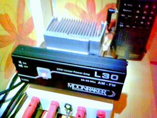

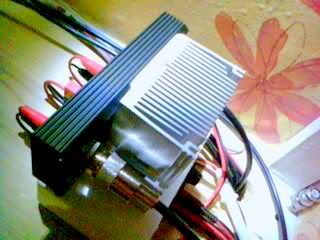

Hi to all.
Well i opted for passive over the forced air cooling of an axial fan, as its right next to my chair in the living room, noise etc.
It was a tight squeeze with the fastenings, but rivet heads side in offered the lowest safest profile, i wanted the heat sink in the other position, but 2 x SO239 sockets would not allow room, about half the amplifier is covered by the heat sink, the important part the power transistors fixing area part.
Bit of an ordeal unbolting the SO239 sockets, and unsolder the power transistor, allowing room on the hole drilling and metal work, so not the most attractive of thermal solutions, but it should do the job, and i keep telling myself its practical, not suppose to win a beauty contest, hope it works, tested short over only made sure ive not killed the amp, longer overs later. :)

Well Dave,
I gotta say, it looks good to me! but then again, I am less concerned about some of aesthetics of things. That is something in the line of what I was thinking of... but I just wasn't sure it would be very effective. I'm glad to hear its running a bit cooler.

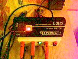

Hi Matt. Yes no problems with it now, been using it for the best part of a week, three times a day keep in contact with me Mum, first laid up after a knee operation, she just got walking again, then 2 weeks ago was attacked in the street by a mugger trying to get her bag, pulled her to the floor smashing her hip, another operation, plate screws etc, laid up again, the radio is a life line in terms of contact, anyway wont dwell on the negatives, but yes amplifier runnig fine.
