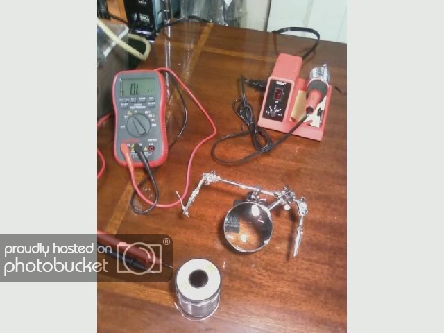

Well as you may or may not know, I am pretty new to electronics. I have some equipment but I still lack other important aspects of a good electronics lab. Well some of my previous experiments have been disasters. Maybe I was trying for something too extravagant. But I thought I'd try something more useful that will actually help me and won't kill my wallet or time in the process.
This is currently what my setup looks like. Multimeter (Amprobe AM-220), soldering iron (Weller WLC-100), solder wire (Kester 44: 63/37), and a third hand.

You seem to be on the right track.
BTW, your equipment seems perfectly acceptable for this sort of work.
I tend to lay out a newspaper to work on so I don't burn the desk :) Cleaning up is then as easy as wrapping up the top couple of sheets and binning them. If you're working with tin/lead solder it helps keep the lead waste (bits of solder and stuff) fairly well contained.
