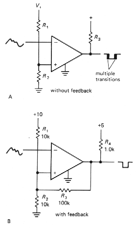

Back at school i remember we had a lesson about using opamps as comparators.
The problem is op-amps are designed to be used in closed-loop, negative feed-back circuits where the differential voltage between the two inputs stays small (because of the negative feedback). When used as a voltage comparator, the op-amp operates open loop and differential inputs can be several volts instead of microvolts or millivolts. Even if the op-amp has a high common mode voltage rating, it may not recover quickly to enter (briefly) a linear mode before changing output state as the differential input voltage approaches zero.
Nor are op-amps optimized for fast, logic-type, transition edges on their outputs, which is where a comparator excels and one of the reasons to use a comparator. The worst problem is making sure the op-amp output states are logic-compatible levels, and that oscillations do not occur during state transitions. In a typical comparator application of a high-speed (wide bandwidth) op-amp, this can be assured with positive feedback and the introduction of hysteresis in the switching points:
Downloaded from http://www.dnp.fmph.uniba.sk/~kollar/je_w/h3_54.gif.
