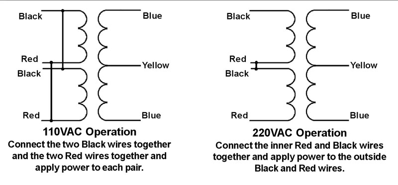

What I would do is (use switchmode PSU as already suggested but keeping closer to your agenda...) try the circuit using the transformer center tap for 12V. Remember that is AC, so once rectified to DC and smoothed, it's going to float up closer to 16V, then once you subtract the dropout voltage of the linear regulator (per the datasheet, a bit under 2.5V @ 4A, and less at lower current), you'll going to get fairly near 13V. If you want an extra ~half a volt on top of that, use schottky diodes instead of silicon for the bridge rectifier.
I assume this is the transformer you're working with?
https://www.mpja.com/24V-4A-Center-Tapped-12-0-12-Transformer/productinfo/27845 TR/

There is no current reduction doing that, AFAIK. You'd still have 4A @12VAC. However, I overlooked something. Since you bought from MPJA, I assume you're in the US, and therefore using 110VAC mains?
If so, take a look at the wiring diagram on MPJA (included below). You might be able to wire it as if you had 220VAC, then the output would be 12V (and 6V at the center tap).
This is where someone else more knowledgeable about transformers could help, as I don't know what effect using the 220VAC wiring (primaries in series) would have on current. Would it result in 1/4th as much so 1A?
If it doesn't quarter the current then it also seems useful to power a 12V fan from 6V (closer to 7VDC) for less wear and noise, if the fan is large enough for that. If as you stated you have a 4"x5" heatsink (assuming it has fins), an 80mm x25mm typical computer fan, spinning at all, should provide enough airflow for ~10W.
It could possibly stay within thermal limits without a fan at all if the heatsink is a good design... you only mentioned 4"x5" and not the height. 4"x5" piece of plate aluminum isn't (usually) enough for 10W but 4"x5"x2" tall with fins, might be. I'd still plan for a fan then go from there deciding if it's necessary unless you have the C/W spec for the heatsink.
Transformers are fairly robust devices and series running of the primaries will do no harm.

^ I'm not suggesting it would do harm but rather, for 110VAC it runs the two primaries in parallel to get 4A output. If using 110VAC with the two primaries in series, shouldn't that result in 1/4, (or 1/8th?) the current? I don't know. This wouldn't be a hard thing to measure and change.
Drawing 1A @ 12v secondary will result in a 12VA primary power draw.
I'm skeptical about this, won't it be in the range of 60% efficent so power in > out? Plus I don't know how changing the primaries from parallel to series would change efficiency. I suspect it'd go up but could be wrong.
Transformers are 1:1 devices as far as VA is concerned.
If you want to get technical ( really unnecessary) it's power out is equal to power in , less any losses.
Transformer losses are in this instance, negligible and of zero concern.
With reference to the supplied diagrams and assuming they are the correct type.
If one looks at it in this manner, ......with one primary winding only connected to 110v, output would be 1/2.
So 2 primaries connected in series would be a further 1/2, so to answer your query..... 1/4.
But it all irrelevant really.
All the op has to do is connect one winding as you suggested and he should be fine.
Yes, the 110volt schematic of the MPJ transformer is correct. If power in equals power out, can I assume that the 4 amps on the 24volt secondary will remain as 4 amps on the output if I use the 12volt center tap?
