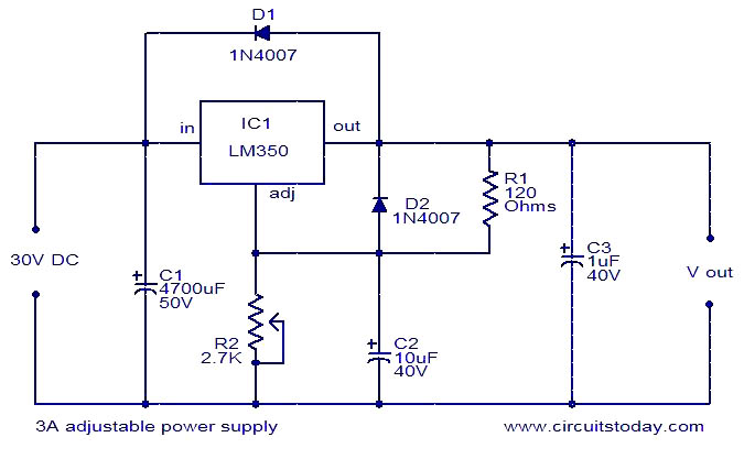

LM350T variable voltage regulator
Mike Taylor
Sep 11, 2015
21
Sep 11, 2015
21
12 V, 3 amp transformer
Bridge using 4 three amp diodes
LM350T
One Ohm per ft nichrome wire for testing
Aluminum heatsink and fan
22,000 mfd capacitor on out side of bridge.
Problem
The output voltage is fine at 800 mA. As I continue decreasing the load resistance the output voltage starts dropping but the output current stays relatively the same. It's acting more like a constant current regulator.
Desired out voltage is 6.3V.
I need 2 amp output at 6.3V. Any idea what is wrong?

I did a quick search and came up with this.
http://www.circuitstoday.com/3a-adjustable-regulator-using-lm350
Maybe you can modify it for your needs?
Can you post a list of components you have used (part #s)? Maybe a schematic?

That is the circuit I'm using. I have not added the caps yet. Parts list at top of first msg.
I think I got a bag of mislabeled LM417's. Tried 4 out of the bag with same results. Some cheap stuff from China. I've made many of these and never encountered this before.
Not without your actual schematic. Too many variables. OBTW, you will be moving over 15 W in the device. Heatsink?

Sir Mike . . . . .
We confirm the components that you utilized, along with the somewhat uber- healthy selection of the 22K Ufd's of initial raw DC filtering.
In using our Right Honorable and Esteemed "bigone5500"'s reference schematic, but, with our yet not FULLY knowing YOUR circuitry utilized:
The utilization of secondary C2 and C3 electrolytics are of definite importance.
With manufacturers harping on utilization tantalum types for C3, but I have never found that "cut in stone", with the possiblity of squirrelly operation at some voltage and current nodes.
Also, the selection of the value of R1, as it is directly related to the current limiting and foldback aspect of the 350's internal regulatory circuitry.
Get it too low of a value, and some overiding constant current mode tendencies will start showing up .
Your transformers voltage and current capability spec certainly seems sound, since you are dropping from a hefty raw 12 ++++++ volts all the way down to a 6 VDC level.
But, for further analysis, it would be nice to have feedback of the RAW DC voltage coming into the 350 at sample points of 100 ma-500 ma and your mentioned 800 ma and then at 1 amp . . . and 2 and 3 amps current draw, if the latter 3 levels are now being attainable.
The mention of power dissipation at the full voltage and current condition, and stress on the 350, can be scaled down by the shunting of the input to output terminals of the 350 with a fixed power resistor.
Its ohmmic value is being selected so that half of the power passage current will be will divided beween it and the 350.
With the 350 then saying:
what ?? none of the caps ??
of not, how do you expect the circuit to work correctly
again as has been asked several times .... show us YOUR circuit diagram AND a couple of photos of your construction
the ability of people to give you good advice depends on the quality of information you supply

my bad. I have fat fingers. Meant to say LM317.
I have examined by circuit closely. The voltage regulator is acting just like a 317 leaving me to believe that my new package of 10 from China were just miss-labeled. 22,000 mfd was all I could find in my bin. I aim to replace it with a 4700 mfd. no biggie. I just ordered 10 TI LM350T. Mike

i know that with a lm317 you have to put a 0.1 uf cap on the input of the regulator (the 0.1uf cap isn't the filter capacitor though) and a 1 uf capacitor on the output of the regulator

:eek:As "dark side" said, you need the capacitors..:cool:
double check the pinouts of the LM317, maybe connections are transposed....
Are you sure R1 is 120 ohms? Is it maybe something much less?
Is there actually a connection from "adj" pin thru the pot to gnd?
If this connection is missing it will behave like a current limiter..
