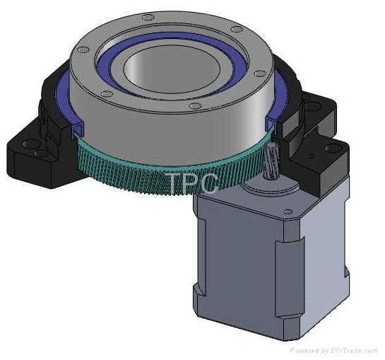

How many posts has there been by now talking about using gears/belts and driving a separate hollow shaft (bearing) with a regular motor?
You don't seem to have even clicked the link I mentioned twice by now, which leads to images like this:
http://fastech.co.kr/bbs/data/cheditor4/1207/MllraJ5HHMLWAebcVB5O.jpg
Which shows how it ''clearly doesn't'' have to.
You're blaming me that I'm not being clear at all when the said link was posted already and others didn't have an issue understanding my posts so far and saying I don't know what I'm asking for. I appreciate everyone's help, but in your posts so far you have shown that you didn't really read the previous posts and just want to argue how that's not the case and I'm being confusing and not knowing my needs instead. Nobody wants to read all this.

I would spend about $300-400 for an off the shelf solution, if there is any. The only ones I found use gears and are meant to run no more than 200 RPM. Please let me know if you find what I need somewhere else.
Otherwise there seem to be 3 homemade solutions:
1) building my own motor with wide hollow shaft
2) ordinary motor+gear+bearing setup (like in above image)
3) ordinary motor + belt + bearing
1 will be difficult for me and maybe not good enough, 2 I feel will make too much noise and the teeth will wear off faster.
Solution 3 sounds promising, but I'd like to know what off the shelf parts there are and which I will need to get milled myself.

I would go for the belt solution.
You will need to decide the size of the tube and the torque required.
If you decide on a tube of 25mm OD then the bearings will be quite large to hold it. Two bearings in plummer blocks spaced 100mm will give stability.
If the torque is low, a flat belt will do and could run directly on the tube. It may be able to run directly on the motor shaft, giving a large speed reduction so allowing a small high speed motor. I use a wooden pulley on my coil winder motor which seems to work OK.
For more torque, a toothed belt could be used with a toothed pulley on the motor.
A V belt will be well over the top and will need considerable power to bend the belt and to make it slide in and out of the pulleys.

Thanks for this. A ''square flange bearing'' seems like a pretty close out of the box solution: http://www.ebay.com/sch/i.html?_sacat=0&_nkw=square+flange+bearing&_frs=1
The 4 holes would make it easy to attach the top disc which holds the diffuser and mirror on it. An inset could be machined in the area highlighted in this image, where the belt will go and not slip and rotate the whole thing,
As for attaching the whole thing to the base of the device, I see two set screws, maybe adding two more and/or gluing to a thick pipe would be fine.
I'm not sure how much torque I'll need. The disc, with the diffuser and mirror will be around 1 kg I believe, and the whole thing will be enclosed in an acrylic dome.

These bearings are probably deep groove ball bearings so they can take some axial load as well as radial load. They will probably have a enough clearance to make them floppy. Thus to get a shaft without wobble you need two bearings. Cars and washing machines use preloaded bearings to take out this clearance.
I would use two fixed bearings and a rotating tube which can be driven directly by a belt.
