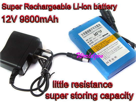

I should also mention that the most common power sources are CCTV or power tool batteries. Theyr'e typically around 6800 mAH give or take.
The ones I personally use are:
Lithium-ion Battery 12V 9800mA
* Module:T-1298A
* In-put:12.6VDC
* Out-put:12.6-10.8V
* Capacity :9800mAH
