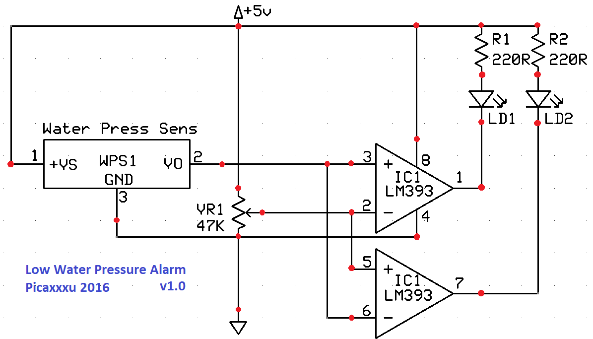

I've been following you for ages, now decided to register and share with you my design, to hear your thoughts and ideas about it, and maybe improve it.

- So I decided to measure the coolant circuit pressure. When pressure drops below some level, means there's a leak somewhere, and an alarm will be turned on.
Design:
So this is what I've got so far:
WPS1 will be a 5v 15PSI water pressure sensor, VOut ranges from 0.5v (0 psi) to 5v (15 psi).
LD1 - Red alarm LED
LD2 - Green OK LED
I'm using a LM393 dual comparator, with same reference and threshold but inverted between comparators, meaning that when comparator A is 'on', comparator B will be 'off', and vice versa. So when LM393's pin 3 voltage (coming from pressure sensor) is below reference the red LD1 will light up, and LD2 will go off. If voltage on pin 3 goes above reference, then LD1 will go off and green LD2 will be on.
Reference voltage is set using VR1, wich will be set to normal pressure when car is running idle.
I've breadboarded this, and it seems to be working fine.
I still don't have the pressure sensor, so I've just been testing with random input voltages, and it seems to be working as intended.
Still, since I'm a newbie enthusiast, I think there's always room for improvement.
Will it work as intended once assembled on car? Should I add any kind of protection or noise filter?
Any comments, thoughts or suggestions on this will be appreciated.

When the systems leaks coolant , temperature and pressure increase so your whole idea cannot work. As far as probes are concerned, the resistance will not be zero without coolant but the opposite. There was a cure for the electrolysis action, gererate a type of ac signal to pass to the probes and use appropriate circuit to detect that. Built a couple that worked well but that was a long time ago. Should be something on a google search.

Hi Bluejets, thank you for your input.
How will pressure increase when there's a leak? If there's a blown hose, presure will be leaking, thus decreases.
My concern, since I have not received the sensor yet, is if a cold idle running engine has a measurable pressure, enough to be distiguished from a leak.
You're right, about the opposite resistance, rookie mistake.
I did make a while ago a bench working model of the probes approach, thats when I noticed electrolysis, and decided to search another path. I searched about it back then, and found about AC, but honestly I can't quite understand AC, and couldn't make or find a circuit that suited my needs.
