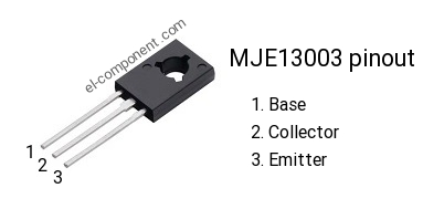

Note:
1. Running PCB through dim bulb
2. No fluorescent bulb attached
3. No autoranging meter
Agree 315V across C2
Agree voltages look quite strange:
Code:
              Q1                                               Q2
      Martin    Dries                                  Martin   Dries
B     315        136                                     0        0
C     310        315                                             137
E     210        137                                              0
Ohms at Q2
B 18Ω
C OL
E 5Ω
My reading of 136V at B of Q1 does not short the lamp
Can we agree that the pinouts of MJE13003 are as shown below?
Moderators note : used code tags to preserve spaces

Yes, pinout the same.
