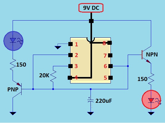

Hello Everyone,
I am in need of some assistance. My current project is to create a small sign with LEDs to attract attention. After reviewing all the different options, I found a method presented on YouTube which would best suit my purposes. I have gone through the video to determine the component the person used for the project.
TITLE: How to Make a Pulsing/Fading LED Circuit
URL: HTTP World Wide Web YouTube dot com /watch?v=qLAi7hkDuYw
The components he descriibed in the project in the video are below.
555 timer
1000 microFarad capacitor
2N222A Transistor
150 ohm resistor
1200 ohm resistor
LEDs
9v Transistor battery
My question to your experts is this. Can you tell me what wattage are the resistors?
Also, what is the best way to add a second LED, so they will fade/pulse in sync with each other?
Would love to add a potentiometer to adjust the fading rate, any suggestions?
I would love to hear from anyone who had replicated this project.

Welcome to EP, @Chris Zanowick!
What the YouTube video shows is a "Monkey See, Monkey Do" demonstration with zero explanation of how the circuit works. Do you really expect to learn anything by replicating this project?
If you look and listen carefully, you will notice that near the end of the video, when the 2N2222A transistor (NPN type) is being connected, that the narrative description does not agree with the actual placement of the wires. The schematic reference for part of the bread-board circuit is shown below:
The LED in blue, its 150 Ω current-limiting resistor, and the PNP type transistor are not part of the bread-board demonstration. Also, the 20 kΩ resistor has been replaced with 1200 Ω and the 220 μF capacitor has been replaced with 1000 μF.
In the bread-board demonstration, the collector, not the emitter, of the 2N2222A NPN transistor is connected to the positive 9 V supply rail. The 150 Ω resistor is connected to the emitter of the transistor, not the collector. This agrees with the schematic posted above and also available through this link.
The video is poorly made (it is difficult to see where some of the wires connect to the positive and negative power rails; the base, emitter and collector terminals of the transistor are hidden; the polarity of the LED is impossible to determine by inspection) and the video is incorrectly narrated. The worst parts are the comments that follow below the video. These are composed by the blind leading the blind. Some of the "advice" is just plain wrong, like connecting multiple LEDs in parallel. For example, this comment:
1/4 watt will be fine. Larger is ok too.
Another LED in series with the existing one may work (it may also change the behaviour somewhat). Another alternative is another 150Ω resistor and LED placed in parallel with the existing one. This may also change the timing slightly.
Replace the 20k resistor with a 1k resistor in series with a 50k pot.

Hi Steve,
Thanks so much for your input. I thought that I would do a few breadboard simulations on TinkerCAD with various designs. Setup three and there are many out there. Some work better than others, assuming the simulation accurately represents the behavior of the design. Many of the circuit designs are not verified to be operational as claimed.
It has been many years, since I did some fairly in depth electronics work, thought 1/4 watt was right. Many of the designs don't mention all the specifications of the components. Guessing a bit on what some of these guys stating.
One of my designs in the simulator has a 100k pot, forgot the other resistor. But, It still works in the simulation. How much of a change in behavior do you think I would see by adding the fixed resistor into series with it?
I did set the LEDs up in series with only one resistor. Simulation seems to be okay with that. I haven't been able to determine whether it being in series or parallel will generate more synchronization of LEDs. I only need to use two for the project.
I would like to try one or more other designs, before I settle on the best of the three I have right now. Unless, there is a better one out there.
Looking at the designs, none of the ones I have been evaluating have a power switch in them. Generally where is the best place to put that switch. Right now I have one setup near the battery. I set it up quickly and threw it on the positive side for the time being, until I can go back through and clean up the layout.
I'll upload an image of it when I get it cleaned up a bit for the benefit of all to see.
That is generally the appropriate place.
Sure. Let me tell you that I'm certain the behaviour will differ depending on whether you have two LEDs in series with one resistor, or two strings (of 1 LED and 1 resistor) placed in parallel.
Feel free to experiment and see if one suits you better than the other.

A simulation is only as good as the model from which it is constructed. Without actual construction, using real parts, there is no way to validate whether the model is accurate or not. Does this mean simulation is useless? Of course not, but one needs to be aware of one's limitations, as Dirty Harry (portrayed by Clint Eastwood) would say. Any simulation needs at least one "reality check" against real parts in a real world. But of course you are aware of this fact from your statement:

The purpose of the fixed resistor is to limit the minimum value of resistance you can insert. Some circuits behave poorly (or not at all) if the potentiometer (wired as a rheostat or variable resistor) is set to "zero" value. Since this is a simulation, go ahead and add the fixed resistor in series with the potentiometer. Then you decide how much change in behavior occurs.
In a real circuit, if this resistance falls to zero (or too close to zero) the 555 will be destroyed.

After asking about the fix resistor in line with the potentiometer, was a bit a stupid question on my part. Believe I already knew the answer before asking it, or at least after clicking the "Post Reply" button on the page. Logic would dictate the potentiometer most likely adjusts to zero and the fix one is necessary to have some sort of resistance on that leg of the circuit with the 0 ohm setting of the pot. But, thanks for the warning that it could damage the 555 timer. Very good to know for everyone.
Is there any particular power and voltage ratings I need to pay special attention to for potentiometers for these types of projects? Don't see any of those specifications mentioned for the ones used on breadboards.
From what I have been researching, the design I am primarily working with seems to generate the best sloped wave for the fading. Oscilloscope would really help confirm that.
Always use potentiometers to attenuate or select low voltage, low power signals. Avoid wiring potentiometers as variable resistors (rheostats), but if you need to do that, always include a series resistor to limit the minimum value of resistance you can "dial in."
You can purchase pots with power rating from a few hundred milliwatts to several watts, but for most hobby uses you will be working with less than a half watt of power dissipation and voltages of around twenty-four volts or less. Always calculate the maximum power a potentiometer will have to dissipate. If the calculations yield power levels that exceed the rated power dissipation of the potentiometer, either replace the potentiometer with a higher rated power, or change your circuit to decrease the amount of power dissipated.
Remember to have fun and "let the smoke out" less frequently as you progress in experience and knowledge.

So, getting back on-topic, if I were to summarize LED pulsing and fading using a 555 timer IC, there are two methods that I have seen used, one more robust than the other. The first method, using the circuit you posted, takes advantage of the 555 ability to both source and sink current from its output, pin 3. The circuit charges and discharges a capacitor through a fixed resistor connected to pin 3. This causes a "curvy" sawtooth shaped voltage waveform to occur across the capacitor, and this voltage in turn causes the conduction of a transistor to alternately increase and decrease. One or two LEDs can be wired in series with a fixed current-limiting resistor from "ground" to:the emitter of the transistor, the collector being connected to the positive supply. This part of the circuit constitutes an emitter follower: the voltage on the emitter (with respect to ground) "follows" the voltage on the base, minus the voltage drop across the emitter-base junction. Thus the emitter reproduces the "curvy" sawtooth voltage appearing across the capacitor. There are many variations possible on this theme, but the important thing to remember is the current through the LED is made proportional to the conductance of the transistor, which is operating as a linear device instead of as an on/off switch.
The other way to control pulsing and fading is to modulate the duty cycle of a pulse-width modulated PWM signal. WIth PWM, the voltage sent to the LED (or two or more series-connected LEDs) is constant in peak amplitude but goes to zero voltage periodically. The current-limiting resistor can be lower in value than would be necessary if voltage were applied continuously, because the average current passed to the LED string is just the maximum current multiplied by the duty cycle: the ratio of the time the pulse is on to the time it is off.
Pulses are typically generated at a high frequency, a few hundred to a few thousand hertz, to avoid the perception of flicker. Fading is controlled by varying the duty cycle over a longer period of time, typically a few seconds to few minutes depending on the desired fading effect. The advantage of PWM is the current supplied to the LED (or LEDs) is switched through a transistor that is either on or off. An ideal transistor dissipates very little power when fully on and no power at all when fully off. The only time power is dissipated in the transistor is when it is making the transition between the on and off states. A good design will guarantee a very fast transition to minimize power losses.
Some microprocessors, including the Arduino, implement PWM on one or more output pins by means of internal hardware configuration registers, A software program (a sketch in Arduino-speak) loads the registers and thus determines the PWM duty cycle. All you need to do is connect the PWM output pin to an appropriate transistor driver circuit. This is a good Arduino programming exercise after you get past programming the blinking of the built-in LED on the Arduino board.
