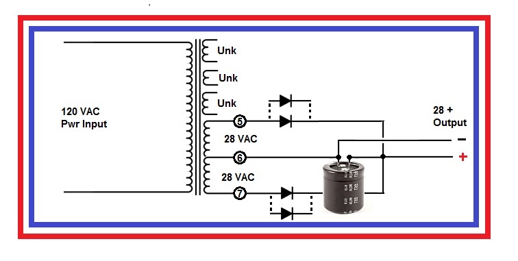

Sir jonathon . . . . . .
Well the first thing noticed on that transformer shown is the AC line spec of having that 2.5 amp fuse on the AC primary . . . its loooooooking gooooood !
This must be from a Japonie . . . . . Matsushita family of product, being salvaged from one of those first day "big screen" tv's that used crt's that got used
by their owners down to their last bit of emission.
( Along with the crappy picture that they produced in that final poor emissive state. )
You found a string of different voltages, but don't look too hopefully in utilizing any "quasi-tandem-series--parallel -series aiding-push pull" arrangements in
order to eventually come out close to the voltage output that you now need.
The windings were for different voltages and SPECIFIC current needs in different portions of the set.
Ergo . . .having a mix-mash in the variance of wire gauges used for different windings.
HOWEVER . . . . .fortunately you have given that first pair of windings outputs as 28 VAC and that sounds like, just what you need.
Assuredly those windings were utilized for the differential +&- supply voltages for the audio power amplifier of the set, with logic of having system sound as
equally impressive as its associated "big screen".
You possibly lost me on ALL of the series of voltages to pin connections referencing that you gave in your write up, but I am just looking at your GOOD photo
of the unit and seeing that THE winding of interest is being the 5-6-7 terminal combo with those HEAVY copper foil traces associated with them.
(There IS some POWER being carried therewith !)
28 VAC --- 0 ---28 VAC would produce 56 VAC across the ends , so that would not be conducive of the use of a FWB rectifier.
So just use its equivalency, by use of a full wave rectifier configuration by letting pin 6 be the power supply's common negative ground.
Then one of two 2-3 amp rated power diodes has its anode connected to transformer terminal 5 and another, like matching diode has its anode connected to terminal 7.
The diodes cathodes are connected and your filter capacitor(s) + connection is made to them.
The filter capacitor(s) - connection is made to terminal 6.
Therewith, you then will be having a power supply which will be putting out in the order of 28 VDC, under the loading imposed by the the motor of that linear
actuator. . . . . .aka . . . . "Deltadrive"

So after re-reading - a few times, here is my best guess at what you are suggesting I do. Take out the solder in the red rectangle. Then connect pins numbered 5,6 and 7 at the arrows indicated.

Sir jonawald. . . . . .
Lets just call the situations equal . . . as I was having like difficulty in picking out ALL of the connections on that perf board construction of yours, since I only confirmed 95 % of it with another 5 % having a possible error factor at the corner Molex connectors.
Since you were not sure of my technical verbiage, as related to incorporating the utilization of a full wave rectifier circuit, a schematic is accompanying this post.
Since you used separate discrete diodes , vice a FWB potted block, you could beef up and parallel the pairs as per the dotted in option.
Howyoudoittoit:
Thassit
73's de Edd
