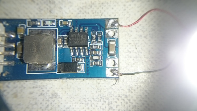

the reason why i'm asking is i'm using this chip"DC-DC 6-24V 12V/24V to 5V 3A CAR USB Charger Module"
to charge my phone at car but the charging in really really slow as it may take like 30 min to just go 2% up which make no sense for me since it says it can support up to 3A , but if i'm using wall charger it can fully charge in 1 hour.
does anyone know what might be the reason?
USB standard is 0.5 A max. To allow higher currents and thus charging rates some manufacturers use resistor coded chargers or cables that tell the smartphone that a higher current can be drawn from the charger (read here, scroll down to "how to get faster charging"). The charger you use very likely does not have this coding and therefore the smartphone will draw only 500 mA.
Still, how much current is drawn is mandated by the smartphone's charging electronics, not by the charger.

so what can i do to make the phone charge at the full speed and draw as much current it want from the buck converter?
You'll have to find out which coding on the USB data lines (typically a few resistors) is required to "tell" the phone that the charger is capable of more than 500 mA. See the link in my post #10. The resisstor values are not standardized (at least not on USB A or B connectors - USB C is a different matter). Therefore try to find the right combination for your smartphone. An example for a Samsung 2 A smartphone charger is given here.

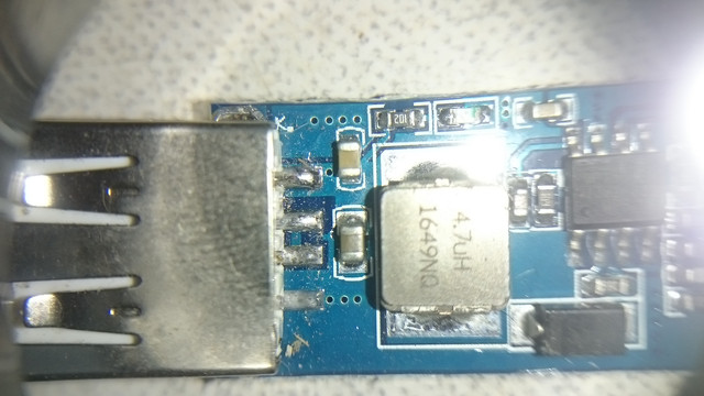

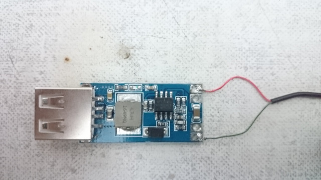

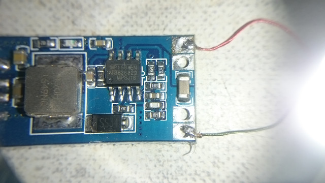

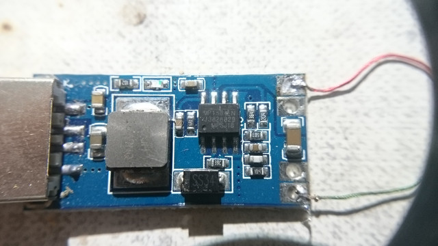

this is the buck converter i'm using
how can i make it provide more current to charge my phone
since the original adapter is sealed and i don't like to broke it, if i measure the resistance between the middle pins in the USB pot and each side of the voltage positive and negative, will that give me the right value of the resistore

Put an Ohmmeter across D+ and D-to see wheter there are resistors at all - have the charger unplugged for a while before you measure to ensure there is no residual voltage on the output.
I can't find any reference describing the particular setup for the Xcharge system your phone uses.
