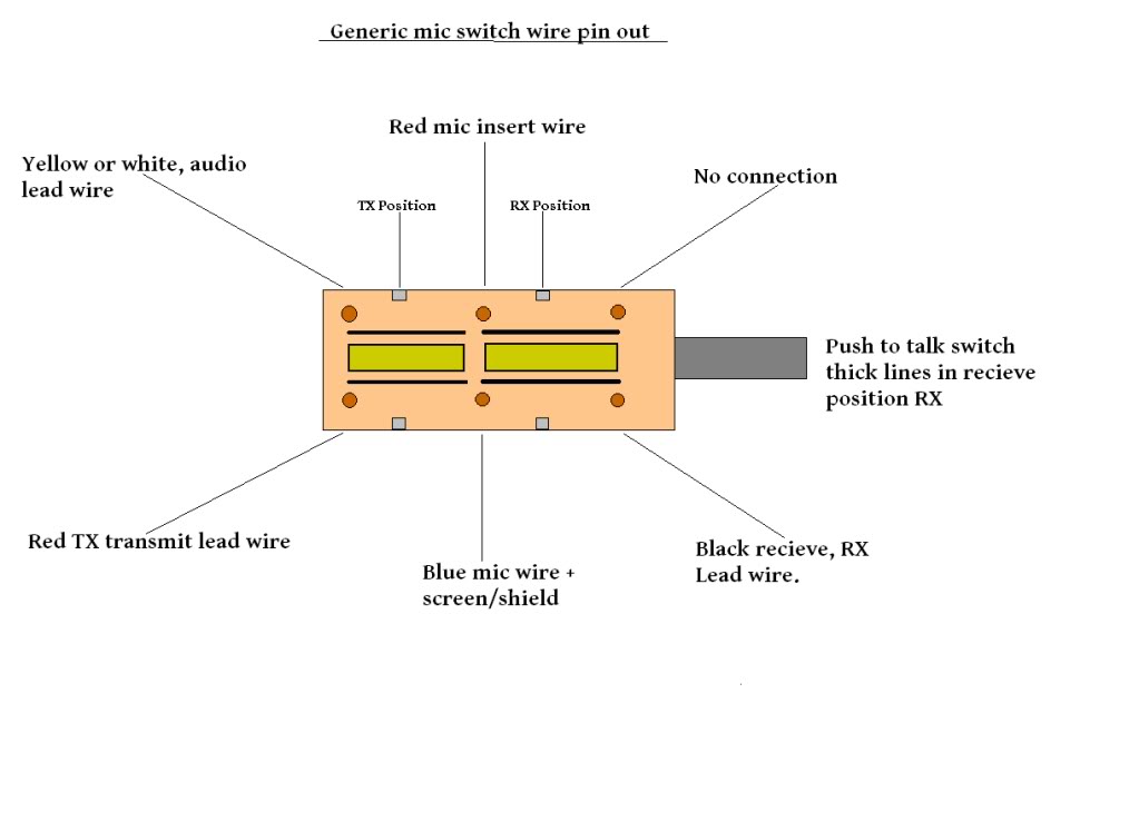

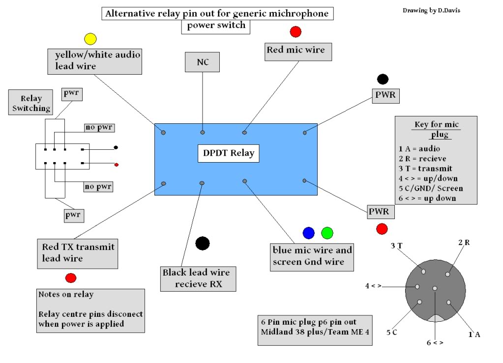

Hi all.
Ive not asked many questions on things iam doing, but i have one now.
What this is, well i have had enough of cheap return slide switches in my CB microphones.
The project i have tried and tested first was a quick set up.
Its a relay DPDT to replace the slide switch, and a momentary switch to operate the relay, any way iam using a dynamic microphone on a tripod, problem, the audio is to quiet, so ive bought a small kit, a preamp for the microphones output.
I will leave links to the relay pin out and what was the old switch, and the kit, why a kit, well its quick in this instance, i could build the preamp from a schematic, but this kits is peanuts, so i went with that, as well it was in my local maplins store 5 minutes away, ok iam lazy really.
On production of the said idea, can any one see a problem combining the preamp with the microphone, oh the mic has a 500 ohm coil, the preamp an out of 1k.
Reasons why, well the relay/momentary switch will way outlive a cheap mic slide return switch. any feedback appreciated. Dave. PS links below.

I forgot the microphone, i described it already, the link for it is below, its actually this model.
http://www.maplin.co.uk/general-purpose-dynamic-microphone-9832

Didn't mean to ignore you, but it was kind of hard to spot the question inside all that information.. ;)
Where did you find the 1k output spec'? I doubt it has more than 10 ohms. Diagram?
The Maplin kit is nothing like the Velleman kit by the same kit name btw..
The Velleman kit also doesn't have a 1k output impedance, even if so stated.
Impedance matching is only important when connecting a limited energy source like an antenna or a mic to an input.
Of course also when connecting long cables, to avoid reflections garbling the signal.
In this case the amp power is "unlimited" and gain can be turned up to compensate for any loss that might occur.
But if the 741 is good enough for a CB mic preamp - that is something someone else might have an opinion about.

Ok. Velleman seems to have two versions by the same name, the other having a dual op-amp, 50k input and 10 ohms output impedance.
The one you last referred to has 2.2k input and max 500 ohms (with RV1 mid-way, going down to 10 ohms with it at either end) output impedance.
But like I said, the only important thing here is the microphone impedance being equal to or lower than the amp input.

No, not stereo, just a two-stage amplifier (by means of a dual amp package)..
The output is incorrectly stated as 1k, forget that number..
It has up to 40dB gain, which is a lot btw..
