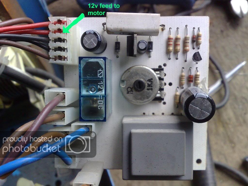

hi everyone i am completely new to the site so please bear with me.
i have a mig welder and i suspect the pcb is at fault could anyone help me identify the pcb and what you think my problem could be
basically the power to the motor(12v) has stopped. the 12v feed should go to the wire arrowed
thanks in advance for any help
i have checked the continuity throughout the pcb so can only assume it is one of the components .
looking at the pcb tracks it looks like it is the big white resistor? on top
soz im not the best with terminology

That large resistor looks like a current sense resistor. If it has gone open circuit then you may well get the symptom you describe.
The resistance is printed on it, read this and measure across the leads with a multimeter. Don't be surprised if there is some difference because it is in circuit, but if it reads more than 10% higher than what is printed on the side that's bad.
There are other components which could be the problem, but try this one first.

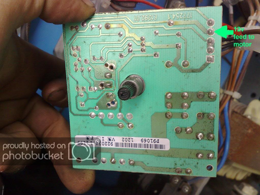

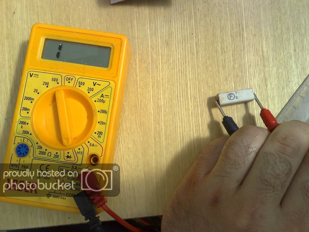

hi there is no resistance when measuring across the big white resistor or when i measure across the 2 contacts on the reverse of the pcb.all the other resistors have resistance.

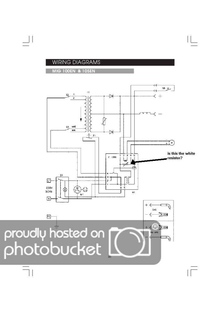

here is the wiring diagram from the clarke website( apparently they are not 100% reliable but its a start)
ive arrowed the resistor that i think is the white one. i always thought that that symbol was for a potentiometer

When you say there is no resistance, is it like you have touched the multimeter probes together, or is it like the multimeter probes are touching nothing?
And what resistance range are you set to? Suitable ones would be x1, or 200, not x1000 or 20k (you want a small number)
it is like the probes are not touching anything ie the display stays on 1.
i have the range set to 200

Ok, that reads as open-circuit, over-range (i.e. over 199.9 ohms) or "infinite" resistance (hardly). That resistor is 35mm long. How long is the original one? 25mm?

The arrowed "potentiometer" in the wiring diagram is probably just a symbolic representation of the whole resistor-transistor-potentiometer circuit.

ah ok thanks mate. with regards to measuring motor resistance, it is a 12 volt motor and i can supply 12v with my power probe and it works fine.
the circuit board it self doesn't have a housing so there is plenty of room for the bigger resistor.
just removed the resistor and measure the resistance and i get nothing so do you think it is almost 100% that this is to blame
if i open it up do you think i will be able to see the open circuit?

It's probably OK -- that looks like what's called a sand resistor; they are typically intended to dissipate a bit more heat than the smaller resistors.
Note you have your multimeter set to test diodes. The "OL" in the display means there's no current flowing through the device being tested (typical test currents are around 1 mA). Make sure you set your meter to the correct mode to measure (although in this case it probably spotted an open circuit OK).
