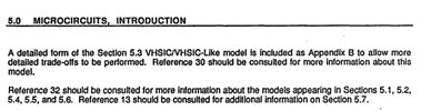

New to this whole MIL-217F and reliability prediction, just have been assigned to determine the failure rate of a module. Was wondering whether anyone has an advise on how to determine the number of gates and/or transistors from a datasheet. Have been looking multiple datasheet for different microcircuits and haven't seen any information about the number of gates and/or transistors in datasheet. Any suggestion/advice/recommendation/best-practice when trying to determine the failure rate using section 5.1 in MIL-217F-N2. Thank.
You are just going to have to count each single transistor in the schematic diagram. haha!
It's called grunt work welcome to the club. I know you're pain!
So drop down and give me 20 push-ups maggot!
:pbut there's a way to ease your pain don't show this to anybody else you got to promise.
Screenshot_20230726_194847.jpgScreenshot_20230726_194622.jpgScreenshot_20230726_194422.jpg

Using the number of gates or transistors is only a proxy for the reliability based on (often not very up-to-date) estimations. If available, use real MTBF data (FIT rates) for the components.
Reliability data is afaik not part of the datasheet. You can often find it in a separate document on the manufacturer's website. If you can't find it, you'll have to ask for it.

That was what I was really wondering about when asking how to determine the # of gates/transistors from a datasheet. I wasn't sure if I was missing something from the datasheet. Like if someone where to look up for a microcircuit component (P/N ADCMP380-1ACBZ-RL7) and check the datasheet for that specific component, where would I look in the datasheet to find out the # of gates/transistors so as to C1 / C2 value from MIL-217. But as Delta Prime commented, it could be that datasheet isn't a second-nature to me. I do appreciate the comment/response. If you have any other advise/suggestion/best-practice so as to improve my ability to better understand how to perform reliability prediction based on MIL-217, it would be most welcome. Thank you.
