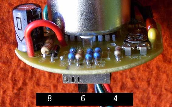

Out of cheapness and spite I have decided to investigate this. I would like to modify a car tachometer that only has options for 4, 6, and 8 cylinders so that it can be used on engines with fewer than 4. Switching between 1, 2, and 4 cylinders would be ideal.
It has a 3-position selector switch with different resistors on each pin, so I assume their resistance determines the signal pulse division. It has an IC, but the ID is obscured by the needle mechanism. Anyone know how I could modify it the way I need?

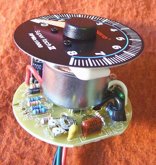

2.)Tach is analog. It's a Sun Super Tach II 0-8000rpm.

I figure the switch and resistors is just for some kind of divider. If it will help, I'll try yo get some detailed pictures of the PCB and components. I'm thinking it might just be easier to make a signal modifier with an optical switch and trigger wheel(to mimic a 4/6/8 cyl engine).

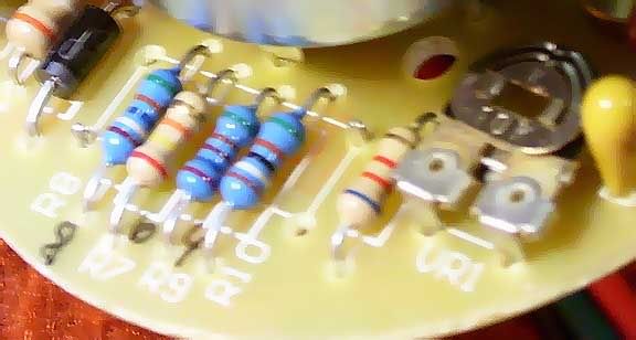

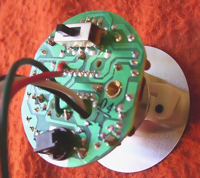

Vi Wh Bl Rd - Gr
7  9  6  2    5% 796 * 100 =79600
Rd Yl Or    - Gld
2  4  3      10% 24 * 1000 =24000
Vi Bl Vi Br - Gr
7  6  7  1    5% 767 * 10                 =7670
Vi Wh Bk Rd - Gr
7  9  0  2    5% 790 * 100 =79000
Those switches can be tricky on the inside.  Some have been set up to short multiple contacts and create unexpected outputs.  Others are just straight forward 3 position switches.
In any case it appears that the resistance is used to control the measurement.
That trim resistor on the side looks very promising.
The shadow and the parts placement make it hard to follow the traces.
It appears like there is a chip under the gauge and the gauge has 2 large pins that straddle the chip.
I would try and work out the circuit diagram of at least the switch the chip and the gauge.
The other parts may be just power regulation.
Once we understand how the switch works to provide resistance to the chip I think we will find that the number of calendars Vs. Revolutions per a second is a simple formula and by replacing some resistors we can do 2, 4, 16 or 24 calendars just by putting the correct resistor on the board.
-Mike

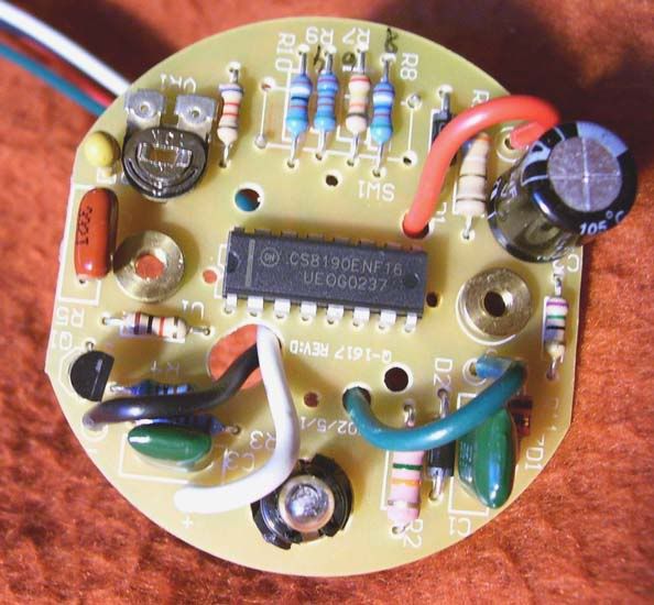

The IC seems to have 16 pins which exclude the in this kind of devices often used LM2917 which have only 14 pins if I remember correctly.  :-\
Theatronics
Jul 12, 2006
158
Jul 12, 2006
158
I would guess that is is a rare custom chip.  It could be a common part, but my experance has been that devices like that often are built around a custom part or one where they scratched the part number off the top.
One way to be sure would be to use some solder wick and just desolder the gauge
and take a look at the chip.  If there is a part number we might just be able to find a Data sheet.
I am guessing it is something like this:
http://www.national.com/pf/LM/LM2917.html
But it could easily be a small microcontroller that has an onboard signal counter and a PWM output driving the gauge.

Yeah, the IC has 16 pins.
However, you might be surprised to see that it still has the part number. Yes, I desoldered the gage part.
It's an ON Semiconductor CS8190ENF16 presision Air Core tachometer/speedometer driver!
ON_Semi_air_core_tach_driver_IC.zip

Great, it’s hacked! You got the formula right there! ;)

Alright, it appears to be just a variation of the example circuit in the data sheet. The cylinder count selector switch just changes the resistance between the negative charge pump input and the frequency-to-voltage output pins (15 & 16). On the 8cyl setting, the resistance is 196k, on 6cyl it is 26k, and 4cyl is 195k....the same as the three blue five-band resistors.
There is a 68k difference between 4 & 6 (33%) and a 62k diff between 6 & 8 (25%). Based on my calculations, I need 449k for a 2 cylinder setting and 573k for a single cylinder. Sometimes I get mixed up in the math, so maybe way out in left field.
EDIT: my calculations were off as I expected, but I got it right after some trial-and-error. It took a 1M resistor and a 470k in series. I tested it on a truck that I know idles at 750rpm. I figured that on the 1cyl setting, 750 x 4 = 3000rpm on the tach. Thats what I got with 1.47M ohms.
