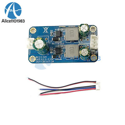

As @Bluejets hinted at, the op is going to need a dual rail PSU to be able to run both those circuits together
This isnt really a problem as there are nice little modules available on ebay etc that take a single rail in and output dual rail supplies
here is a good example ......
