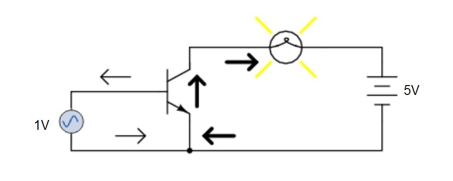

Ok, i'm getting no responses, so a simpler question that will also help. In the common emmiter BJT amp example below, does the 1V signal source see the 5V battery?

I did a quick search to find something close enough:
th
As long as the input signal and output +Supply share a common GND, it is no problem to have a 5 or 10 V signal at the gate and a 1000 V power source for the load. The MO in MOSFET is basically a thin sheet of glass rated for the peak drain voltage.

Thank you! Like i suspected but wasn't sure. Now, i want to interupt discharge from a HV cap and i wasn't planning on grounding it. Let's just say device might have to operate where ground connection isn't available.
Isn't the - of the cap enough of "ground". Does ground have to be physical connection to earth?

I referred to ground being a source of electrons as in the circuit AnalogKid posted above (reproduced below), "ground" is negative terminal of the power supply which IS a source of electrons. In reality, electrons barely move - 10cm to 1m per hour, it is EM wave and it's Poynting Vector that move and carry the energy. Of course true "ground" is not required, only potential difference to make the energy flow through a conductor. Yes, electrons are everywhere. Very fabric of space is densly packed with virtual electron-positron pairs in eternal jitter due to fundamental imbalance of their electric and magnetic components - these little bubbles of energy literally make up all-there-is, forces and "matter".
