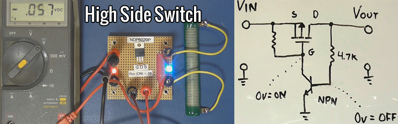

I currently have the existing circuit to control my car horn via a relay. I am a beginner but trying to figure out how I can replace the relay with a mosfet. I got it working to control the horm via 3.3v to an n channel mosfet to sound the horn by using a mosfet to switch a relay to connect 12V direct to pin 2 of the horn. To get rid of the relay and use onlt a high current mosfet I am not sure how to get around the ground fitted at the horn. SHould I use a p-type instead and control the 12v rather than use an n-type to controll access to ground? If so I am a bit lost at that point.

If you are stuck with one side horn grounded then you do a high side switch.

Here's a high-side P-MOSFET switch to power the grounded horn:
It powers the horn with a 3V to 12V input.
The P-MOSFET can be any with at least a 15A, 30V rating.
In your diagram you show the source of the mosfet going to 12V and the drain doing to earth via the diode, is this the right interpretation?
Yes.
A P-MOSFET's normal operating voltage is positive, source-to-drain (negative drain-to-source).
The diode is to suppress any negative spikes from the inductive horn load that might otherwise damage the MOSFET.

So I am a little confused, Instead of the components you suggested I used IRF4905 mosfet and an 2n2222 transistor. I tested it in ciruitlab and got this
However, when I test it in a built circuit on a breadboard and a Veroboard test I get 6.99 volts on the collector of the transistor which is not enough to switch the MOSFET on I think. In circuit lab I see the full 12v on the collector with 3.3v on the base but in real life I only see half the expected value on the gate of the mosfet, 6.99v any ideas why?
I am an idiot, I had the transistor upside down. duhhh !
