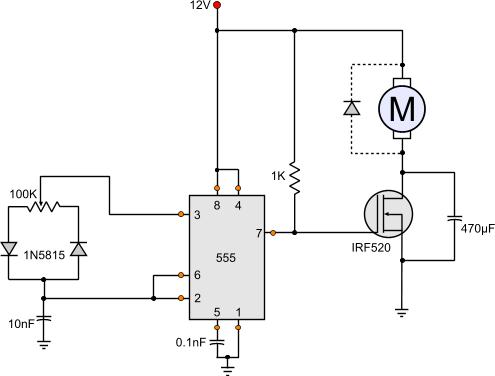

They are matched. What is your opinion on how many can I put in parallel? Will they than share the load? I need it to make a control for a wiper motor and I was thinking to use this circuit.
I was thinking to make a linear PSU but than i need the motor to have a lot of tourque at low speed like around 5-6 volts.

Paralleling of MOSFETs can be done comparatively easy in switching applications, but not so easily in linear applications. This application note gives lots of detailed information. Luckily your application is switching :D
Not good in terms of efficiency. Using a switching controller as in your example reduces the thermal load on the driving transistor(s) considerably. Also note that many power MOSFETs are specifically designed for switching applications but are not well suited to linear operation (again an app-note by NXP).
This circuit is basically correct, but has (imho) a few deficiencies for a practical application:
  1. The 12 V power supply will be very much distorted by the pulsed currrent through the motor and possibly high frequency noiuse from the commutator. I suggest you put an additional LC filter between the 12V supply and the motor.
  2. The 555 likes to have the power supply bufffered (as does most any IC), therefore place a 100 nF capacitor across the 555 from pin 8 to 1.
  3. The control signal from the 555's pin 7 to the gate of the MOSFET should have a series resistor to limit the gate current during switching. As you are going to have multiple MOSFETS, use separate resistors for each MOSFET.
  4. The 555 has a totem pole output. Therefore the 1k Pull up is not required.
    However, as you are going to have multiple MOSFETS, the drive current from the 555 may be insufficient to ensure fast turn-on/turn-off of the MOSFETs. An additional driver circuit may be required.
    The issue is described e.g. here. Figures 14 and 15 respectively show simple discrete transistorized driver circuits.

I just tried this circuit and the ne555 doesn't even have enough power to turn on and off only one mosfet, i just dies after a couple of seconds. And also I forgot to put a resistor on the gate, but that should'nt have been a problem because I was powering only one mosfet. I'm going to have to make additional driver circuit as Herr Harald Kapp had mentioned.
BobK
Jan 5, 2010
7,682
Jan 5, 2010
7,682
The '555 has plenty of power to turn on the MOSFET, they need almost no power, they are voltage driven.
But in the circuit you are using, it is the 1K resistor that supplies a positive voltage to the MOSFET. Depending on the frequency the '555 is running at, this might be too high.
Why are you not using the output pin (pin 3) to drive the MOSFET gate?

What is the pupose of the 470μF across the FET? I would think that this will slow down switching and increase fet dissipation.
That's true for the static case. When switching, however, you have to take into account the gate-source capacitance. The IRF520 has a typical Cgs = 360 pF. When charged with 200 mA from a 555 the rise time of the gate voltage is ~21 ns. Or, in other words, if the rise time is faster, the current needs to be higher. As the typical output rise time or fall time of a 555 is on the order of 100 ns, this should not be the issue here for a single IRF520.
With multiple MOSFETS plus wiring capacitance it may become critical.

I dont know really, i just found this schematic
Yea but I'm using a HRF3205
Harald Kapp
Nov 17, 2011
14,311
Nov 17, 2011
14,311
Sorry, I went by the schematic in post #3.
With an HRS3205 matters get worse as Cgs = 4 nF, 10 times that of the IRF520. With the 200 mA from the 555 the rise time will be accordingly 10 times as long on the order of 200 ns. This may lead to local thermal overload of the MOSFET's internal structure. A faster driver is realy advised then.
