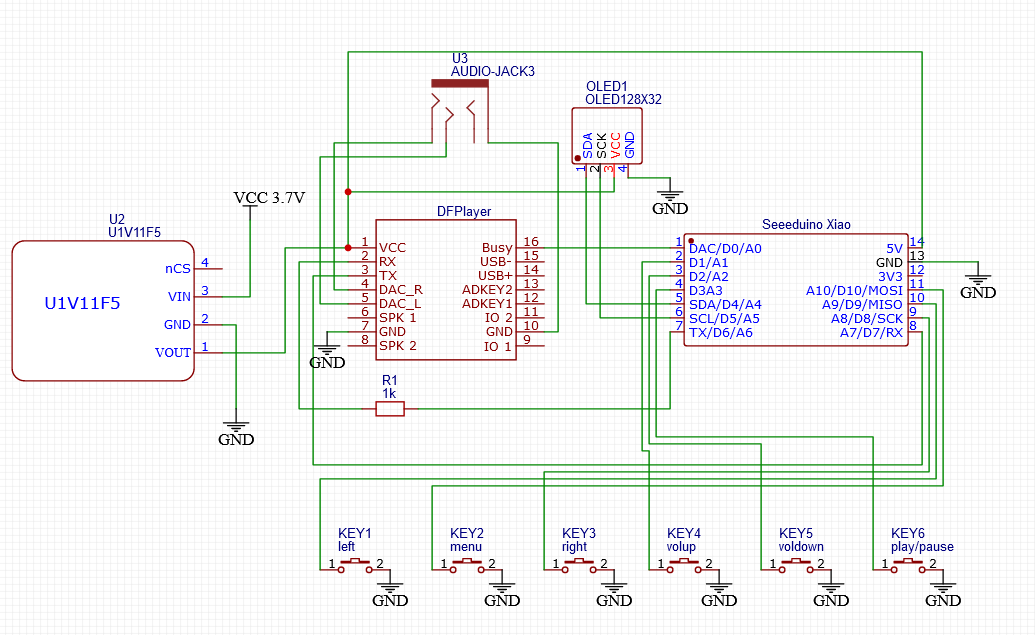

Hi. Got a project going where I use a DfPlayer mini as an Mp3 player.
When starting to play, there is a hum. It isn't there/not noticable when the song starts really playing, but this depends on the song. Low volume on the song tends to mean there is a hum. I'm not sure if the hum is always there, and gets drowned out by the music, or if it stops because the song "uses" those frequencies? As probably quite apparent, I'm no expert. I can imagine it may be interference.
The player sends audio to a 3.5mm jack.
If you search for noise or hum with this playing module, you will get plenty of results. Typically what they refer to is not what I am hearing. There is usually talk about resistors on the TX/RX pins, I have a 1K resistor on one line, nothing else helps on this, 10K, both lines, 1K both lines etc etc doesn't help for this. The noise they refer to is a alternating loud drone. I have this, but don't get it into the audio because I have separated the two grounds of the module. (one ground to ground electrically, one ground to ground audio).
I think I need a filter of some sort, but I don't know where to start. Can someone help? If you need more info let me know.

show a circuit of your layout.
Hopefully this is decent

To determine whether the hum comes from the step-up converter (U1V11F5), remove the converter and connect the rest of the circuit to a good 5 V power supply (not power bank, not a USB wall wart). If the hum vanished, the switching of the step-up regulator is responsible. In that case an LC filter between the step-up regulator's output and the VCC of the other modules can help.
If the hum persists even with a good clean 5 V power supply, check the wiring. Keep the wires as short as possible, connect GND at one point only (star connection), namely the GND pin of the voltage regulator. Do the same for Vcc.
Use shielded wire for the audio output from the player to the audio jack (shield connected to GND).
Don't have this. Could I "simply" make an LC filter to see if this is the case? How do I begin to put that together? I have 470uf, 10uf and some ceramic caps, can I cobble something together with that for now just to see if it works?
This project is on breadboard currently, so not ideal in that respect. Sorry if I'm fumbling in the dark here, but how about putting some metal over it? (making sure it won't short anything) Like a faraday cage?
I'll see if I can fix something up, don't have actual shielded wire, and I suspect it would be a bit impractical to connect. In this case, which ground should I gonnect it to? The audio ground or the "electrical" ground?
I'll also see if I can analyze the audio somehow, to see if I can find out what frequency the noise is, but I'm not sure if I'll be successful.
EDIT: I am able to use the line in on my computer to analyze the audio, however I don't know what I am looking at/for, and there is no clear output suggesting a frequency for the noise

Alright, some experimentation later.
a 470uf cap between VIN and GND to the 5V regulator does nothing.
If I don't call the function to adjust gain on the DFPlayer DAC, it starts at max volume. This does not produce the noise, but it is LOUD and unless your headphones has onboard volume adjust you will destroy your ears. Alternative might be to have max volume, but adjust volume with a pot at output. But I'd prefer to not do it this way, because it's a bit backwards...

Every audio system built on a breadboard produces hum and other interference.
Each wire and each strip of contacts on the breadboard is an antenna that picks up electrical 50Hz or 60Hz that is all around the breadboard.
ALL home audio systems are connected together with shielded audio cables.

The inline inductor of a LC filter should take much of the hum noise away.
Or, just use a ferrite choke.
Ferrite choke on power, aux, cables from module to jack, etc etc no change. Any ideas on inductor values? How to make it? (I may have unsuitable cable) It leads me to believe this may be something else I am hearing. It may be better described as white noise?
Right, but what does this look like when we are talking breadboard scale? I get that there is interference, but the shielded cables I can get are large, at least 1.5mm^2. I don't see how I would work this on a breadboard, because it is tiny distance with large cable that will be even smaller distance when I eventually mount this on some kind of board. How do I practically solve this?
I've tried using other audio jack, various different grounding, various 470uf cap positions, ferrite bead here and there.
The board has an onboard DAC. I can set the gain and volume in software. If the volume and gain is max, there is no noise. leads me to believe I should look at doing something in the region between the Mp3 module and the 3.5mm jack.

Done, switching regulator completely out of the circuit, no change.
I'm pretty sure I'm hearing noise introduced by the DFPlayer module.
Still working on doing a test with an absolute minimum of components.

Experiment with a minimal amount of components - one button, DFPlayer and jack and ferrite bead.
Still there. At this stage I'm pretty sure that what I am hearing is introduced by the DFPlayer.
1. What can I try to filter it?
2. Failing that, how do I best use a pot to make a volume control after the module audio output? What is a good value?
(Seeing as the hum is not present at max module volume)
