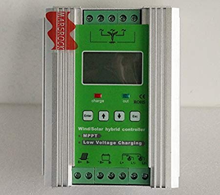

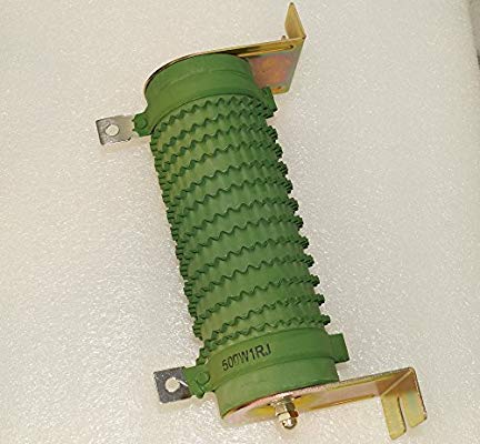

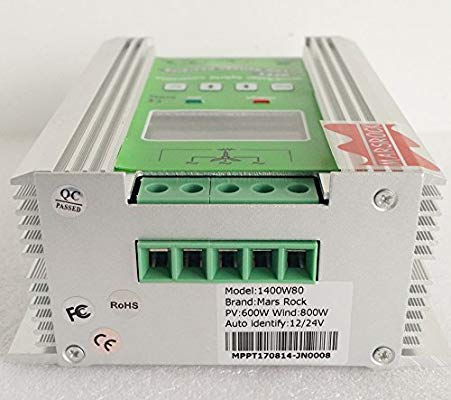

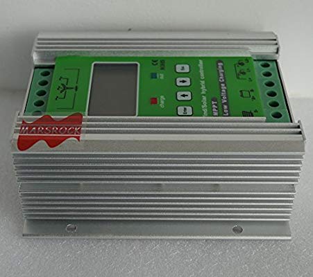

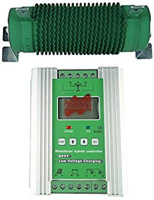

I found this on Amazon
MarsRock 1400W 12V/24V Off Grid MPPT Wind Solar Hybrid Charge Controller Design for Max 800W Wind with Max 600W Solar Panel with Booster Function
but am open to suggestions. My budget is $200 for the charge control, I already have 1 Walmart 105ah battery, 2 100w grape solar panels.

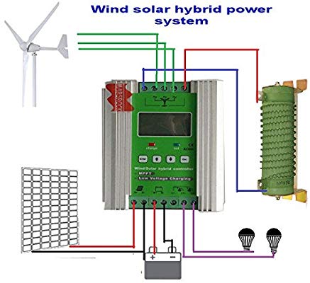

Ok, so around 300 amp since alternator is 140. Would I separate the alternator and solar with two different pwm charge controllers? Or would I go from 300 amp diode into wind input on mppt dual input?
kellys_eye
Jun 25, 2010
6,512
Jun 25, 2010
6,512
The alternator will connect straight to your battery (via the diode). Everything else will be connected as per the last of your pictures.
The wind and/or solar will charge the battery or, when the motor is running, the alternator will do it.
Fuses should be used in the battery and alternator lines.
Blackout
May 21, 2018
15
May 21, 2018
15
So I really don't need a dual input wind and solar charge controller. Because, you would suggest to run from the alternator to a ?amp fuse to the diode and straight to the battery, bypassing the charge controller all together. I do appreciate all your help. Thank you for your time and patience.
